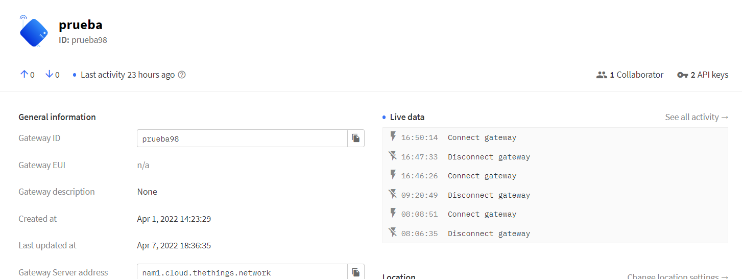

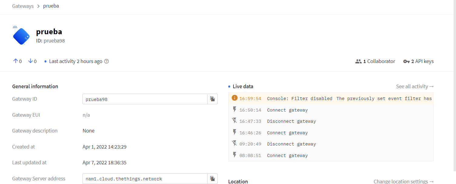

The other worrying thing to me is if you gateway is always connected to power and the internet, it should not connect and disconnect.

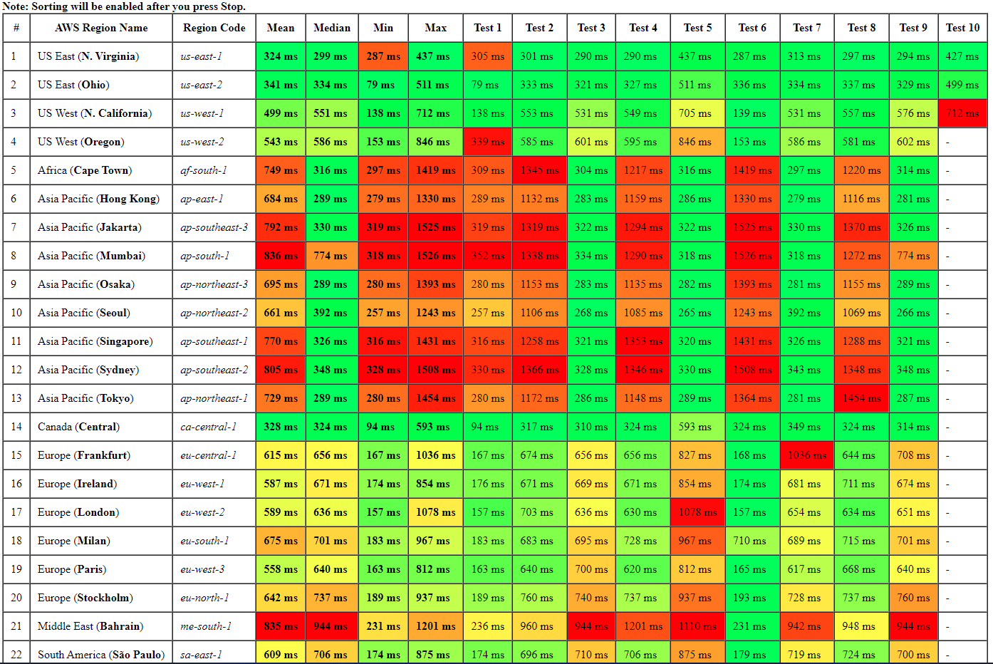

How do your gateway connect to the internet? fiber, 4G ???
Test from the same network your gateway is on the connectivity and latency.
Keep in mind the counters are reset everything the gateway disconnects. So if the last disconnect/connect listed is after the packets were received the counters should be zero.

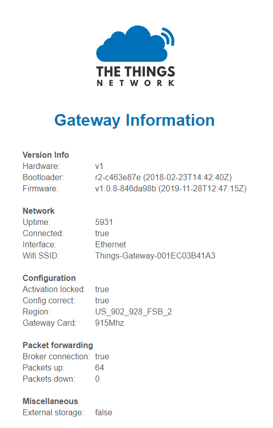

Gateway still connected, no data received
Packets keep arriving
Microwaves. Thanks for the tool!
Around every 30 seconds

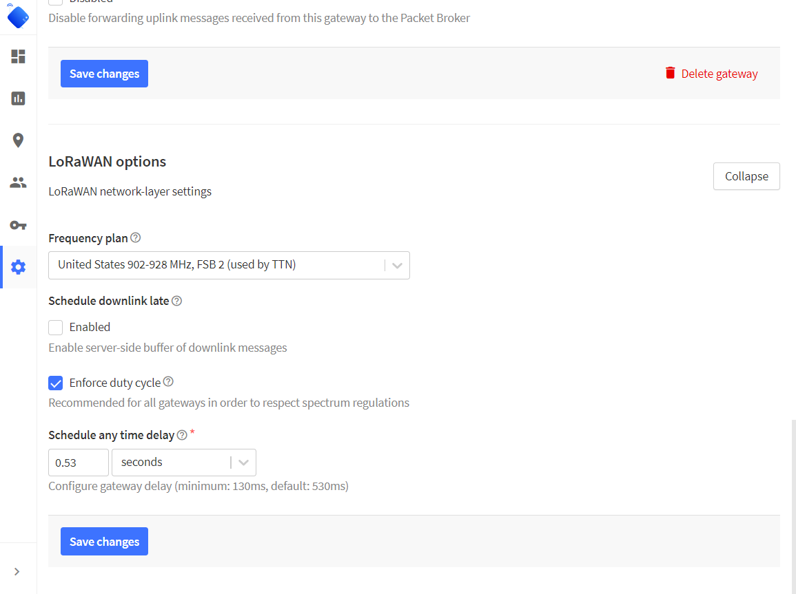

915MHz FSB2
In the case of the MKR WAN 1310 I only enabled channels 8 to 15 and 65
Is it these channels?
are these channels, here’s the webpage
https://www.baranidesign.com/faq-articles/2019/4/23/lorawan-usa-frequencies-channels-and-sub-bands-for-iot-devices

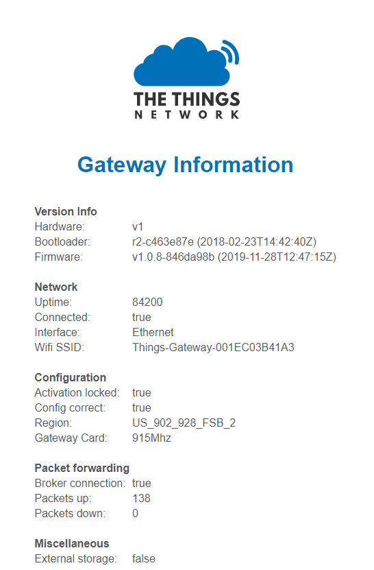

Update
Gateways remains the same. Always on, connected to the TTN
I referred you to the frequencies “The Thing Network” use, you need to check if the frequency correlate.
And I can see your gateway according to the stack is online and no up or down links
Exactly, the problem is that the gateway doesn’t upload the packages that receive.
The “packets up” are the ones that are being sent by the Arduino MKR WAN 1310 but not being uploaded by the gateway

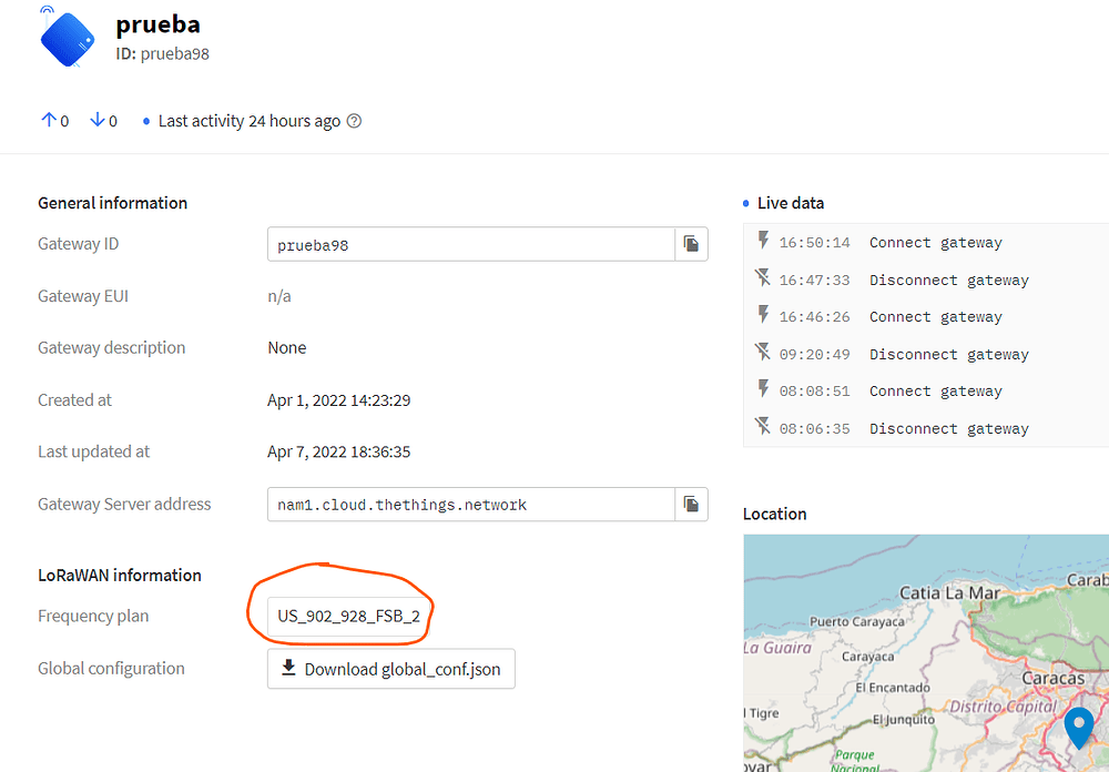

Did you check if your node frequencies are correct?
The frequency is configurated directly on the TTN
in the picture above it is, also here, in the local webpage of the gateway, can be seen.
You need to double check the frequencies used on your node – Arduino MKR WAN 1310
Don’t help to post the same configuration of your gateway, I can see that from the stack

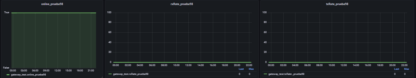

netID: "000013"
tenantID: "ttn"
clusterID: "nam1.cloud.thethings.network"
updatedAt: "2022-04-10T20:46:37.734911Z"
antennaPlacement: "INDOOR"
antennaCount: 1
online: true
rxRate: 0
txRate: 0
region: "US_902_928"

@lorawantesis2022 has posted screen shots of a Kickstarter Gateway earlier. It also shows packets going up but not down. This tells me his gateway server and access key are probably ok.
His screen shot of the TTN Gateway Console does not show his packets getting into the gateway console log although the log shows the gateway connects (except when he switches it off).

I broadly agree……though even if mis-matched keys for node some traffic should still show in gw console, it just wouldn’t be forwarded to application/device console view……I asked >3days ago for full info on device/config, firmware/setting etc. for the node but no info given….just rat-holing on poss GW issues. GW h/w looks ok, gw sw looks ok (right revision) so unless mis configured there is another issue, can’t be a generic problem otherwise many more of the hundreds of KSGWs out there would be screaming too!...with backhaul problem giving NS connection issue….gw ‘thinks’ it has received and ‘uplinked’ traffic, so far screen shots of console say otherwise (unless I’ve missed one), though as Jac pointed out up/down values may be zero due to each new session resetting (pity gw traffic counts etc. don’t persist in V3 in the way they used to for V2 - we lost a valuable measurement & debug assist tool). If node restarted and running OTAA we would then expect to see at least one downlink (JA) as well as at least one uplink(JR)….but showing no useable posts so far and no node details per request hence I switched off from thread engagement….my psychic powers are very limited :wink:
