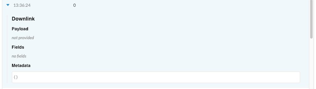

Oh interesting! That would make sense why they only sometimes occur. There is no metadata btw:

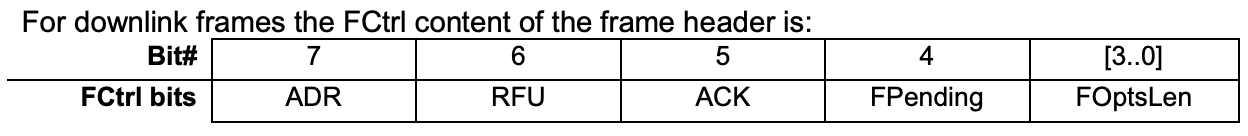

You might also run into FCtrl being hexadecimal 0xA0, or binary 0b10100000, which along with:
…actually indicates it’s indeed an ACK, but also that there are zero bytes in FOpts. So, that apparently indicates ADR does not require any changes on the device, as FOpts includes no MAC commands whatsoever.

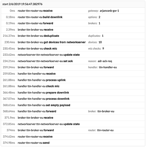

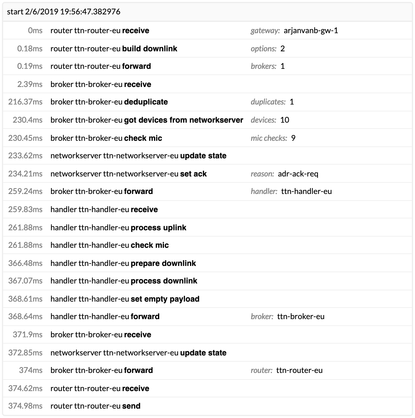

The Trace part in the Traffic might show things like:
networkserver ttn-networkserver-eu set ack reason: adr-ack-req

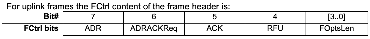

…indicating the node indeed requested an ADR downlink by setting the ADRACKReq bit in the FCtrl of its last uplink:

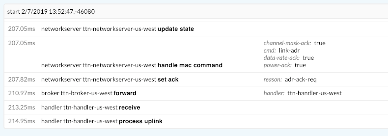

Hello @arjanvanb, I do have access to the gateway, and indeed I did see what you predicted

Ah, I think your node is also confirming previous settings, by setting channel-mask-ack, date-rate-ack and power-ack too. Also, it seems to be issuing a LinkADR MAC command at the same time, and requesting ADR through the adr-ack-req.
