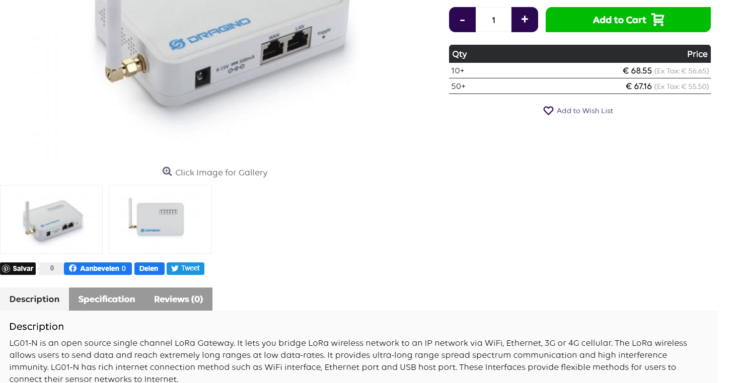

Yeah, this only allows device to device conection, right? “Gateway” like this
I wasn’t going to mention them, you’ve opened your own Pandora’s box.
Step away from the fakeway - it will make your FiPy hurt and the whole of your city’s LoRaWAN will go off line and puppies will go hungry …
Please don’t share pictures like that again - it makes grown men cry!
Realistically that is not useful for much at all… maybe if you are really lucky there is some half thought through demo, maybe…
If you want to do peer to peer things, simply buy nodes, they’re far cheaper anyway. (You’d probably use RadioHead or similar as your software starting point)
But note that peer-to-peer LoRa is not on topic here.
