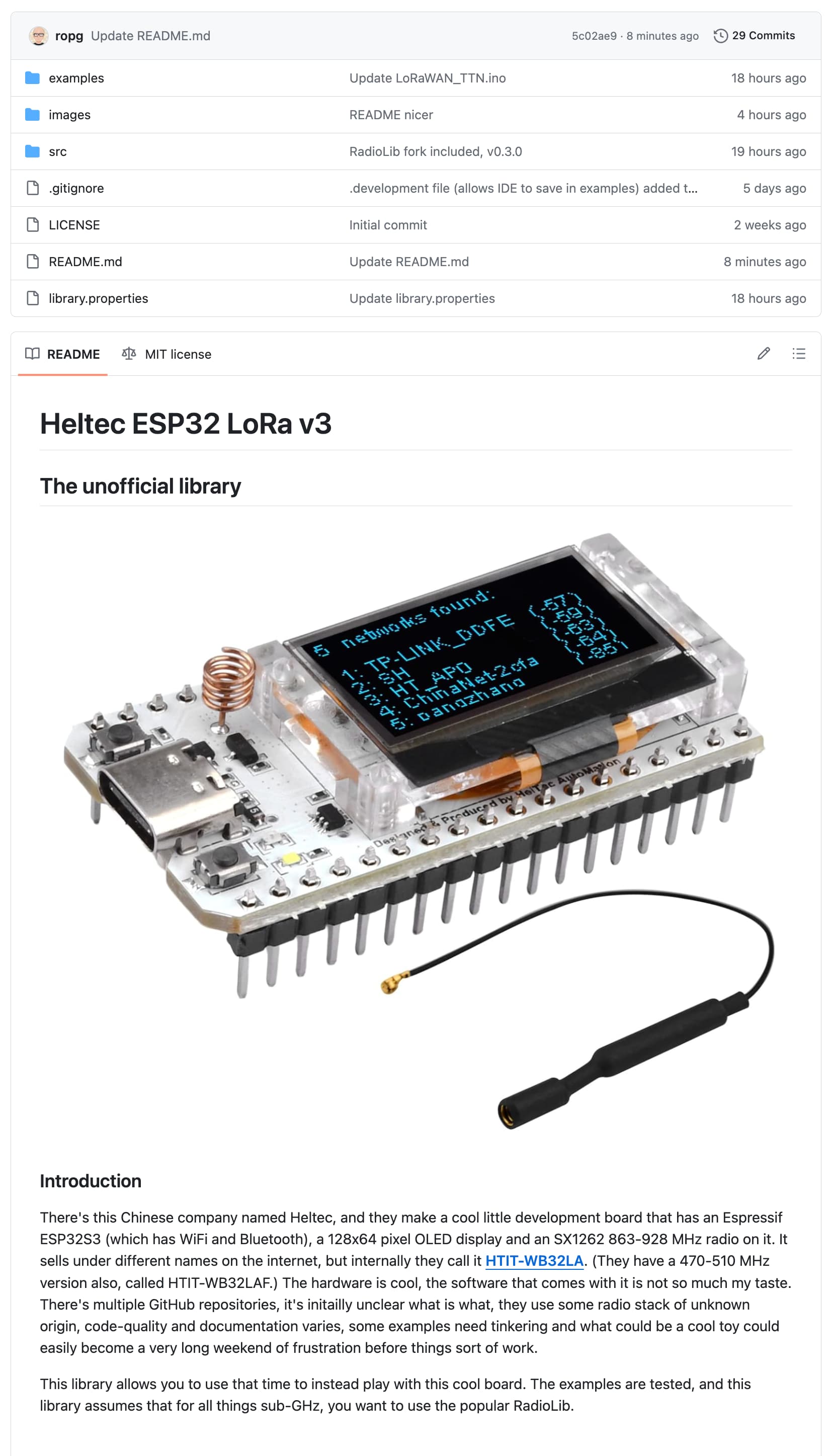

A potential Radiolib derived library for the Heltec ESP32 LoRa v3 board
I created a comprehensive library for those that would prefer to use the Heltec ESP32 LoRa v3 board with RadioLib. Working examples, no more figuring out which half-mandarin repo to use, everything easy-to-use and properly documented. LoRaWAN TTN example with deep sleep between sends, using RTC RAM for medium-term persistence (meaning mostly FCntUp), so the flash doesn’t die on you.
github page

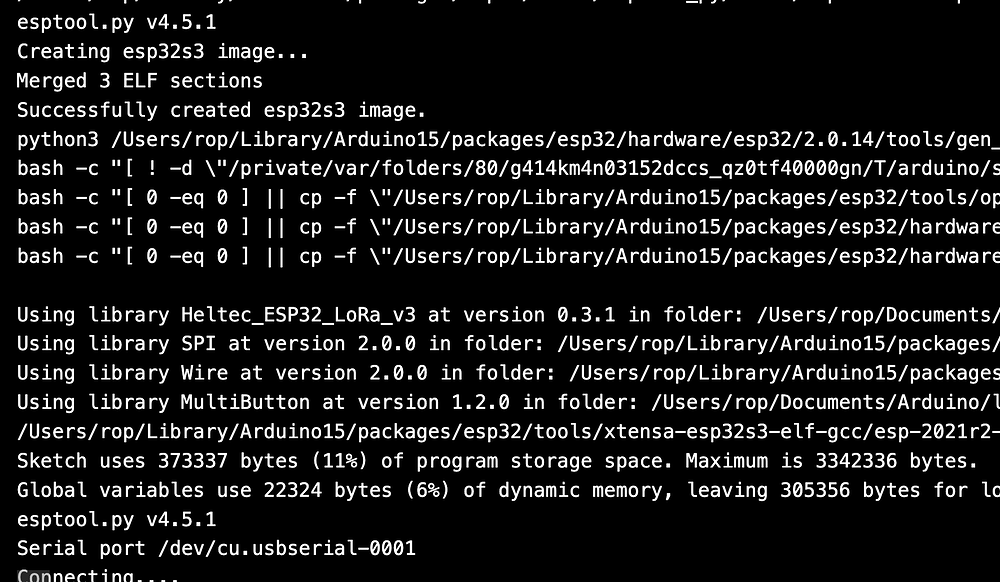

Eh… Does here, just now. Any further info?
Ah, you may need to briefly uninstall RadioLib because this one (for a limited time only) includes my fork and that might confuse the compiler.

/private/var/folders/nr/gn/T/.arduinoIDE/LoRaWAN_TTN/LoRaWAN_TTN.ino:131:33: note: suggested alternative: 'ESP_ERR_TIMEOUT'
   } else if(_radiolib_status == RADIOLIB_ERR_RX_TIMEOUT) {
                                 ESP_ERR_TIMEOUT
/private/var/folders/nr/gn/T/.arduinoIDE/LoRaWAN_TTN/LoRaWAN_TTN.ino:145:5: error: 'EEPROM' was not declared in this scope
     EEPROM.toNVS();
/private/var/folders/nr/gn/T/.arduinoIDE/LoRaWAN_TTN/LoRaWAN_TTN.ino:145:5: note: suggested alternative: 'EIDRM'
     EEPROM.toNVS();
     EIDRM
/private/var/folders/nr/gn/T/.arduinoIDE/LoRaWAN_TTN/LoRaWAN_TTN.ino:161:3: error: 'heltec_deep_sleep' was not declared in this scope
   heltec_deep_sleep((delayMs / 1000) - 5);
/private/var/folders/nr/gn/T/.arduinoIDE/LoRaWAN_TTN/LoRaWAN_TTN.ino:161:3: note: suggested alternative: 'esp_deep_sleep'
   esp_deep_sleep
Multiple libraries were found for "heltec.h"
  Used: /Users/smoketest/Documents/Arduino/libraries/Heltec_ESP32_Dev-Boards
  Not used: /Users/smoketest/Documents/Arduino/libraries/Heltec_ESP32_LoRa_v3
  Not used: /Users/smoketest/Documents/Arduino/libraries/Heltec_ESP8266_Dev-Boards
  Not used: /Users/smoketest/Library/Arduino15/packages/Heltec-esp32/hardware/esp32/1.0.0/libraries/HeltecExample
Using library Heltec ESP32 Dev-Boards at version 1.1.5 in folder: /Users/smoketest/Documents/Arduino/libraries/Heltec_ESP32_Dev-Boards
Using library Wire at version 2.0.0 in folder: /Users/smoketest/Library/Arduino15/packages/Heltec-esp32/hardware/esp32/1.0.0/libraries/Wire
Using library SPI at version 2.0.0 in folder: /Users/smoketest/Library/Arduino15/packages/Heltec-esp32/hardware/esp32/1.0.0/libraries/SPI
Ah, I’ve only tested with Arduino IDE, not with PlatformIO. RST_LoRa should come from Heltec’s boatrd definitions’ pins_arduino.h if you selected this board. I guess I should just #define these pins and not depend on that. Will fix.
As for the EUI placeholders: They must have fallen off in my last copy-paste, put them back in now.
See if what’s in the repo now works better: I defined the GPIO pins locally, added the EUI placeholders back into the example
