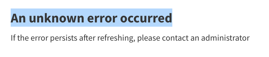

In the console, trying to access my apps, when i try to click on one of them, it give me error message:
eu1.cloud.thethings.network/console/applications/my-app
Screenshot 2021-05-22 at 12.22.05
It only affect one of my apps , on charles proxy, i can see i got a weird 200 with a failure, or sometimes waiting for response body , yet in the response body, i got text answer with some json corresponding to all my end-user nodes. I can share more info in private.

Hi. I have the same problem on TTN V3. Everything was working until today when I received the following error.
“An unknown error occurred. If the error persists after refreshing, please contact an administrator” .
I tried different browsers with no luck. It only happens when I try to access my end devices. I can change my password, log in and log out with no issues.

Unfortunately, the latest deployment introduced an issue in the Console which we will hotfix and deploy likely today. This affects navigating to single end devices in the Console as well as the payload formatter pages for individual end devices.
@Raccoon there should be no issues for the application pages. I’ll investigate this. Couid you send me the name of your application in a private message?
Note that this has been fixed now.

I’m getting:
when i’m trying to access specific devices, either by clicking on it through the end device list, or just by putting the name in the url.
Refreshing, closing and opening the browser does not remove the error.
The error has been there since 11 maybe longer, and it is still there.

they have worked fine before, but i can report that i have 20+ end devices where i get:
I have 20+ devices where i get when i try to view them.
it also occurs when going through the end devise list.
It has worked fine before, I started to get the problem Tuesday (25/05/2021) morning.
