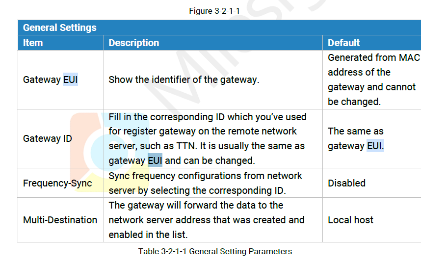

And what does the documentation for that gateway say about the EUI?
It says that it cannot be changed.
And what does it say underneath that bit?
This is all the information provided in the user manual.
Read the whole block - the answer is there.
But to save all our sanity, scroll down …
It says the id you register on a network server, such as TTN … … can be changed.

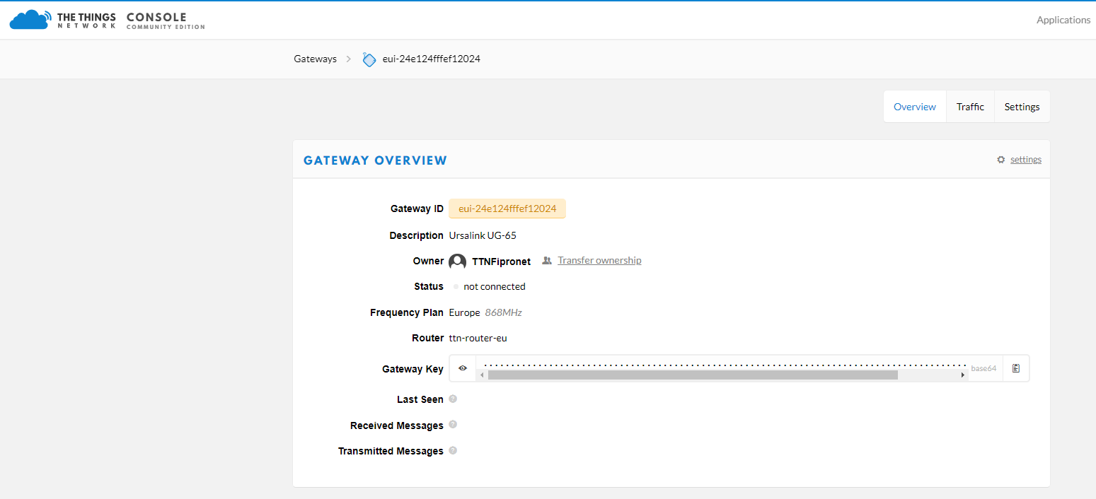

Hello! I know they don’t match. I would like to write down my steps:
1- Deleted the registered gateway accidentally.
2- After seeing my mac address, i changed my gateway id to 24E124FFFEF12024.
3- Registered another gateway with EUI 24E124FFFEF12024.
But it won’t work. image
That shows Registered GW (vs ID) as ending '23…can you condfirm the EUI of the Actual GW NOT the TTN Console registration, please. It may be that you have another problem where TTN Console doesnt show reliably the connection status. Do you have a node registered and App running - can you see any data?

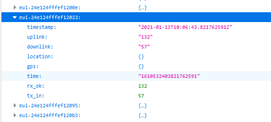

Checking the NOC I can see a '23 GW breifly connected on 13th Jan - I guess yours before deletion?
No GW derived form a MAC ending '24 registered… :slight_smile:

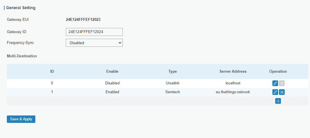

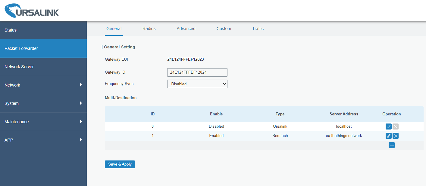

I might have misunderstood you, but if you want me to confirm if my gateway ID and registered gateway EUI do match, here I can send you two photos.image image
I had just updated my last post when you put up the pics. I see no '24 EUI registered through the NOC as you can see. Can you confirm what you deleted in the Console - a '23 or a '24 based registration?
