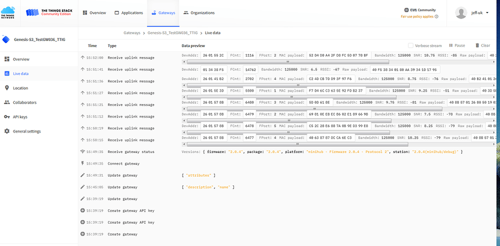

Successful claim/V3 registration:
General Settings were a bit more Jeff friendly wrt info input & use/format:
A quick power cycle for GW to get new settings and V3 registration and ~2 mins later we have traffic :slight_smile:
With GW showing in my TTS(CE) aka TTN V3 GW list as connected :slight_smile:

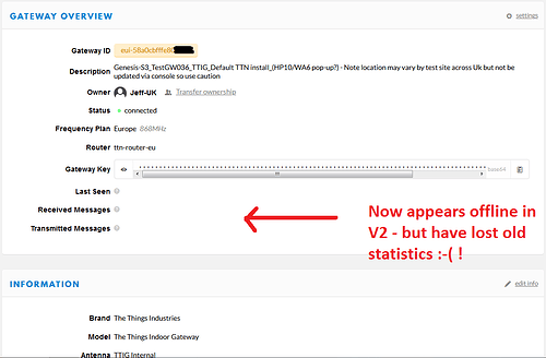

A quick check in V2 console and whilst it still shows as connected (guess that data will update and age over coming minutes and hours *update - now shows as 'unknown’) all data looks to have disappeared and now offline. Only issue is I forgot the vanity grab of handled statistics (uplink/downlink count - think this one had hit >2M uplinks)
