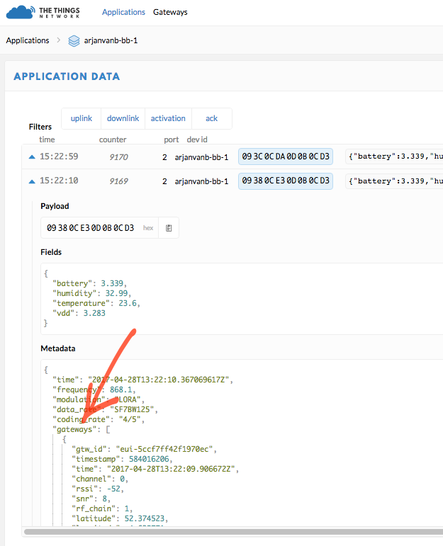

Get the gateway id(s) from the meta data, like from the MQTT JSON message or by expanding an item in the device’s Data page in TTN Console.
TTN Console example
MQTT example

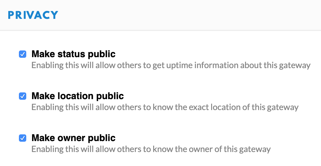

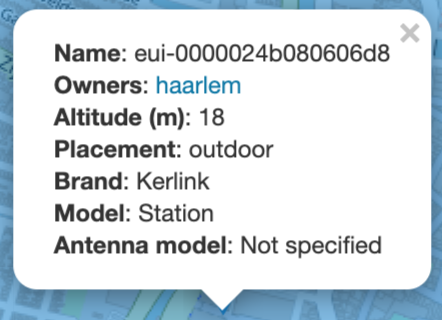

  • Simply find the matching id in the popups of nearby gateways on your local community’s map. This also gives you a link to the owner, if the gateway’s privacy settings allow for that:
    Community map popup
    TTN Console gateway privacy settings

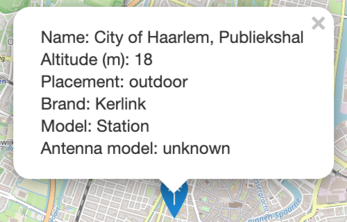

    Note that the community maps show the owner and the id, labeled “Name”. But the global map unfortunately no longer shows ids nor owners. Instead, it shows the description, again labeled “Name”:
    Global map popup
