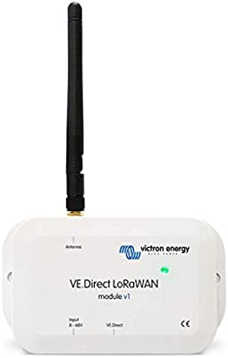

There is something from company Victron, they have a battery monitor and now they also have got a Lorawan connector for their internal bus system.
Prob. that´s what you are looking for?
I use some Victron Solar Controllers for a few of my LoRaWAN/TTN GW’s so would be interested in these - do you have a part number/link to hand? (Am just being lazy - will otherwise google for it later tonight! :wink: )
Shoudl be this one:
:+1: Thanks. Think I recall seeing something on this a while back but forgot about it… a bit pricey but may have to get one just to test :wink:
let me know how it works.

@cultsdotelecomatgmai Tim, what was your impression and experience with the VE.Direct device? Worth trying one? How easy to get data to other dashboards if not using or not focussed on VE’s VRM?

The victron MPPT chargers have a well documented serial output that can be parsed and used to transmit. I’ve used this before parsing it to a TTGO ESP32 device at the time to transmit solar voltage,power, current and battery voltage.
