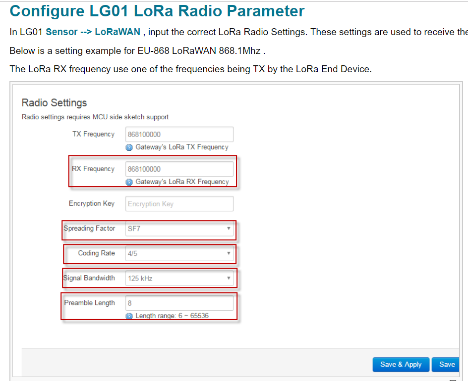

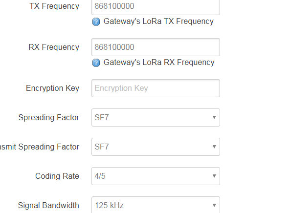

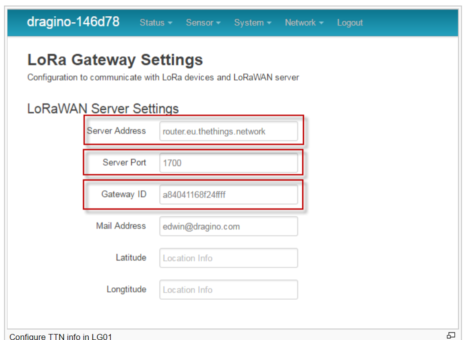

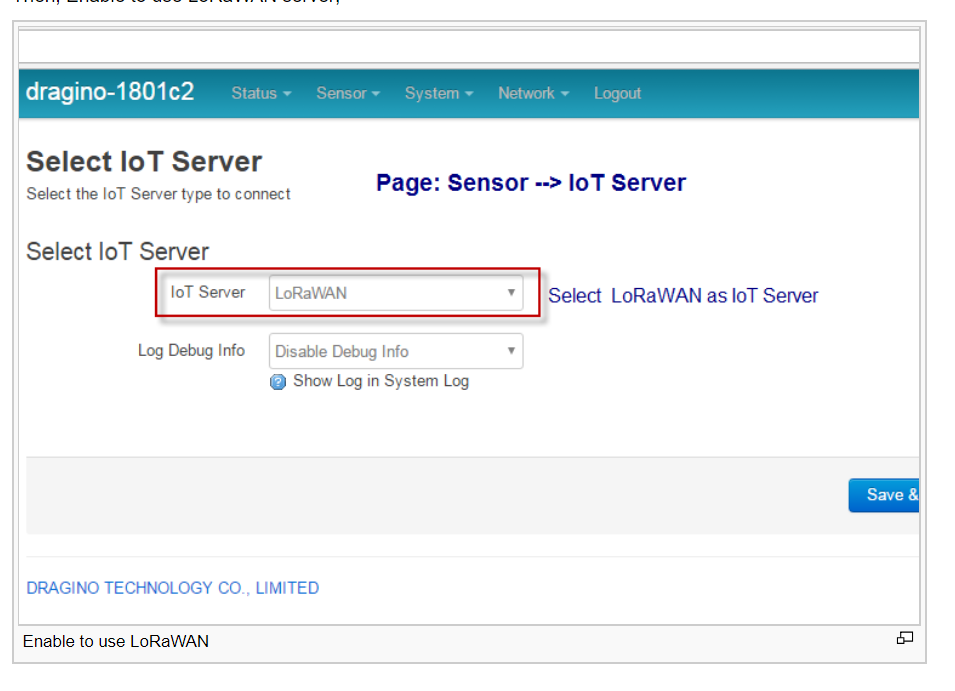

Hello wolfgang
as in the Wiki
Check this first
and then
After that choose the right service you wan’t
then you must that your gateway will be come online
Succes
Johan
But with other word’s following the WiKi step by Step
Hello wolfgang
as in the Wiki
Check this first
and then
Succes
Johan
