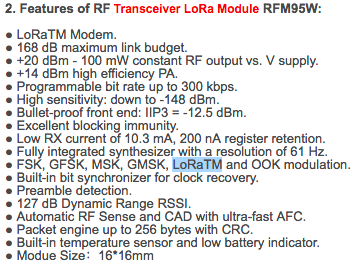

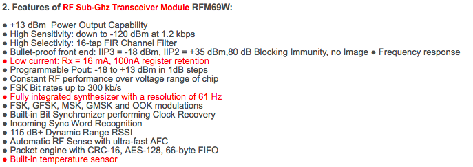

Unfortunately, the RFM69 module does not support LoRa modulation.
So basically you can NOT test LoRaWAN with that transceiver module. You need to get the RFM95 transceiver module, that has LoRa modulation.

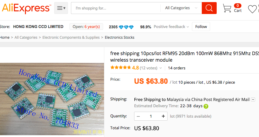

I bought mine from here
