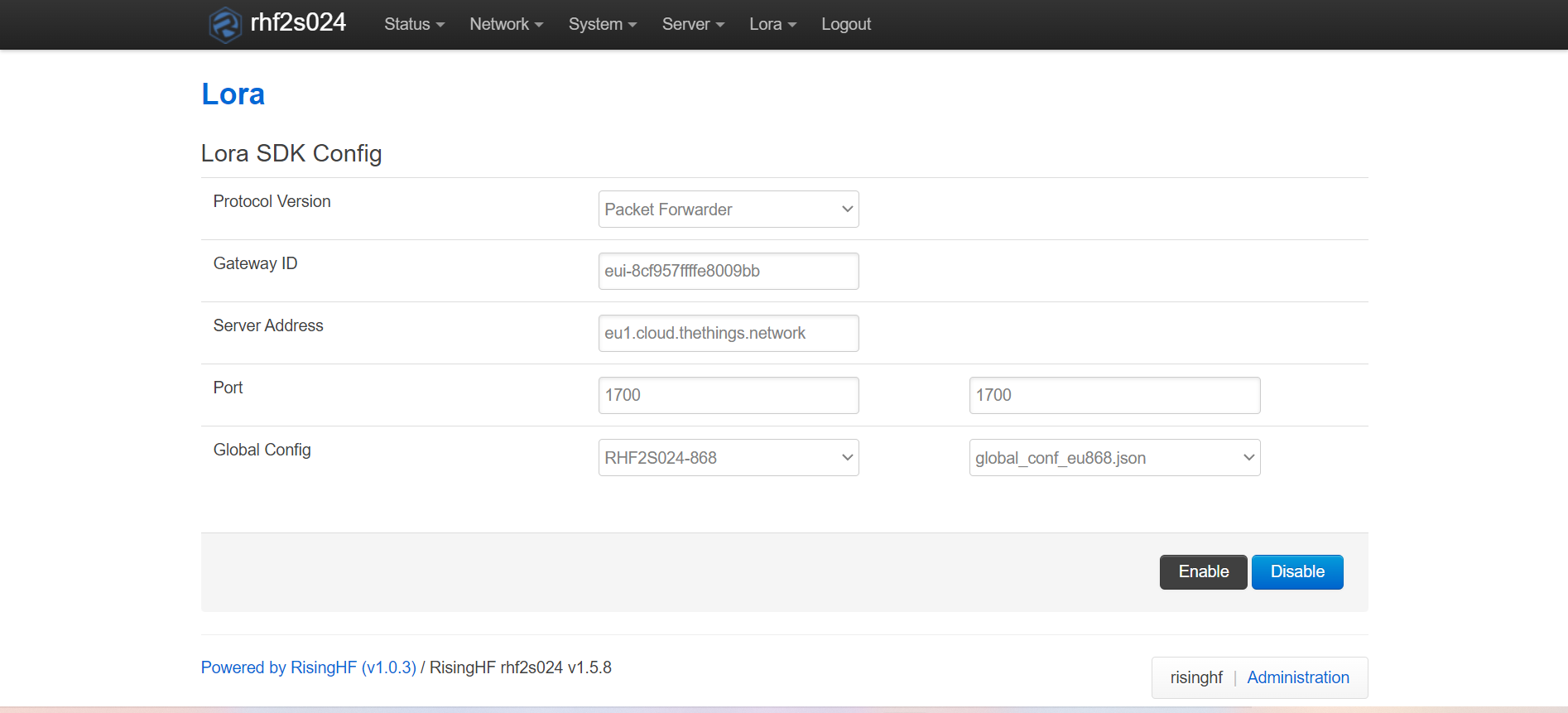

Set both to 1700. Remove ā€˜eui-ā€˜ in the gateway ID field and make sure the value entered in that field is 16 hexadecimal characters. Hit disable. And the enable again.
In TTN change the EUI to the value you entered in gateway ID.
If it still doesn’t work, show us a picture without the menu obscuring the page.

If I did not make a typo your Gateway ID is eui-8cf957ffffe8009bb

Possibly 1 ā€˜f’ too many in both?
…. Or a spurious ā€˜e’ you need to check data entry and consistency…. :frowning:

According to your print screen of the gateway the Gateway ID is eui-8cf957ffffe8009bb, is it the same on the console?

In this hex there are 17 characters, the eui should have 16
Also the characters ā€˜eui-ā€˜ should not be there as I wrote earlier.
On the gateway use only 8cf957fffe8009bb
Then at TTN modify the field called EUI and enter that same value.

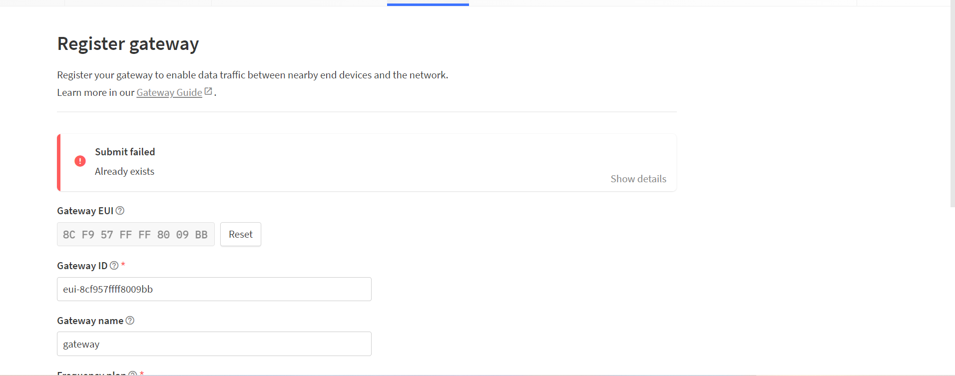

I deleted the gateway now but I can’t register again because it’s still registered when can i do it again?
Re-register with same eui but a new & different gateway Id on the console…. Make sure the gateway Id is one that is unlikely to have been used by someone else - otherwise you will be told already registered and you will think…… loop!

I’m registering with the same eui but I can’t continue because it’s registered again but I have deleted it
Did you read my message at all? If you did you would not be using the same EUI and not run into issues.
