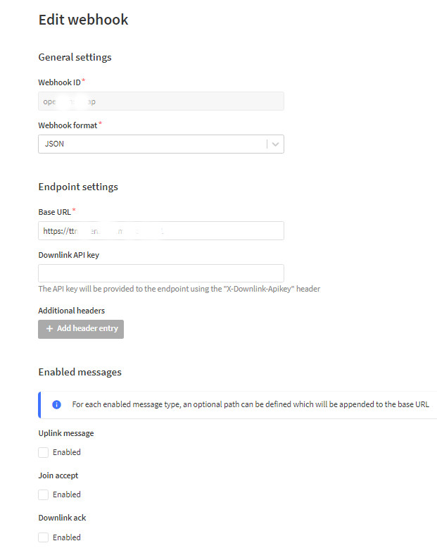

Is there any http-Integration on V3? (webhook)
Like V2: HTTP | The Things Network
Backround: I had a application with http-integration
Access Key
The access key used for downlink
default key
URL
The URL of the endpoint
https://xyz
Method
The HTTP method to use
POST
How will be made the Integration in TTS V3?
E_T

It’s almost identical to V2. I didn’t even break step setting up a WebHook using my V2 PHP scripts - no changes in PHP, just a change of UI but still very similar in V3.
There are some additional options, but if you don’t need them, don’t worry about them. About the only extra you do have to choose is JSON vs Protocol Buffers - V2 was only JSON, so stick with that.
What are the settings in the webhook to get the behavior of the old settings?
Is it possible that the changed format for the payload on the server side leads to problems?
E_T
Like this:
webhook1
The id is like v2, something you can use to id the HTTP integration / Webhook
Webhook format should be JSON (it’s what we had in V2, I don’t have time to learn Protocol Buffers and I have a PHP script that can semi-auto read JSON)
The Base URL is the v2 URL.
The rest can be left alone unless your script requires some authorisation id.
You will have to make substantive changes to picking out the data you want from the new expanded format, but it’s still just JSON. But it’s just a different structure. Not something I’d describe as leading to problems, just different.
