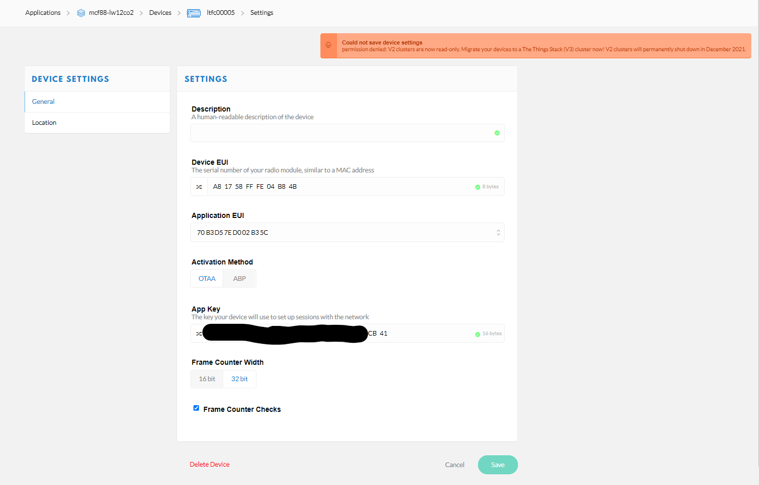

no, when I change the last byte of the app key, the ‘save’ button gets active. but when I click on it the following error is shown:
permission denied: V2 clusters are now read-only. Migrate your devices to a The Things Stack (V3) cluster now! V2 clusters will permanently shut down in December 2021.
Yes, that was problem I saw, and a sad (unintended?) consequence of V2 RO. See my advice/ recommendation to @Inou above as it looks like we have to jump wholesale across to V3 without V2 fall back safety net… I jump after Summer Academy is over! :wink: :crossed_fingers:

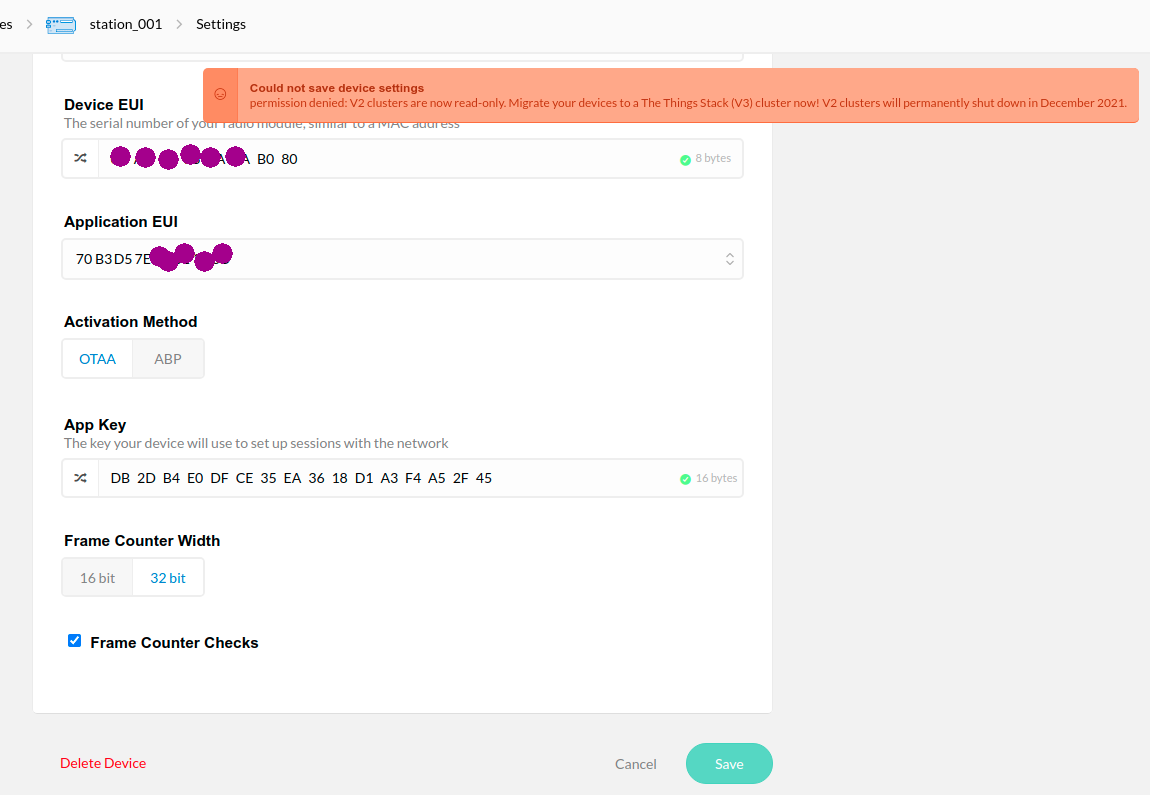

Also getting the error when trying to change the AppKey to prevent a device from joining V2 - allowing me to fall back to V2 if the migration fails.
Screenshot from 2021-08-18 11-57-38
See recommendation in docs here, which recommends changing the AppKey.
https://www.thethingsindustries.com/docs/getting-started/migrating/migrating-from-v2/migrate-using-migration-tool/establish-new-session/#prevent-the-end-device-from-joining-v2-network
If someone can confirm that clearing (not changing) the AppKey works I’ll change the wording in the documentation.
