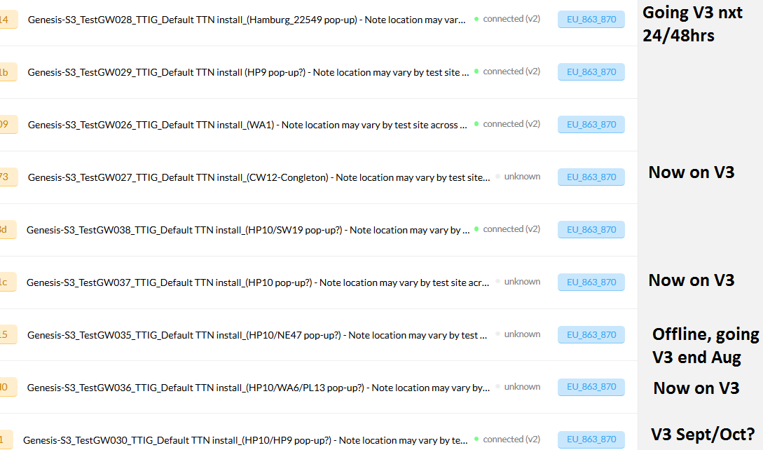

Also discovered cant edit general info (I typically give a general location indicator in description - 1st part or post code etc - helps me scanning list when I only have anonymized eui-blahblah to work of quickly),
and worst still as you know I often relocate GW’s for trials and test deployments, community or client loans etc. and whilst I dont always change location in settings if I remember I like to change description and location on Map for longer term deployments - more than a few days…location cant be changed either. Not adding a new GW just ‘updating’ where in the world it might be, ah well (confuses the hell out of TTN Mapper! with some crazy links shown ;-)) :man_shrugging:
As here:
