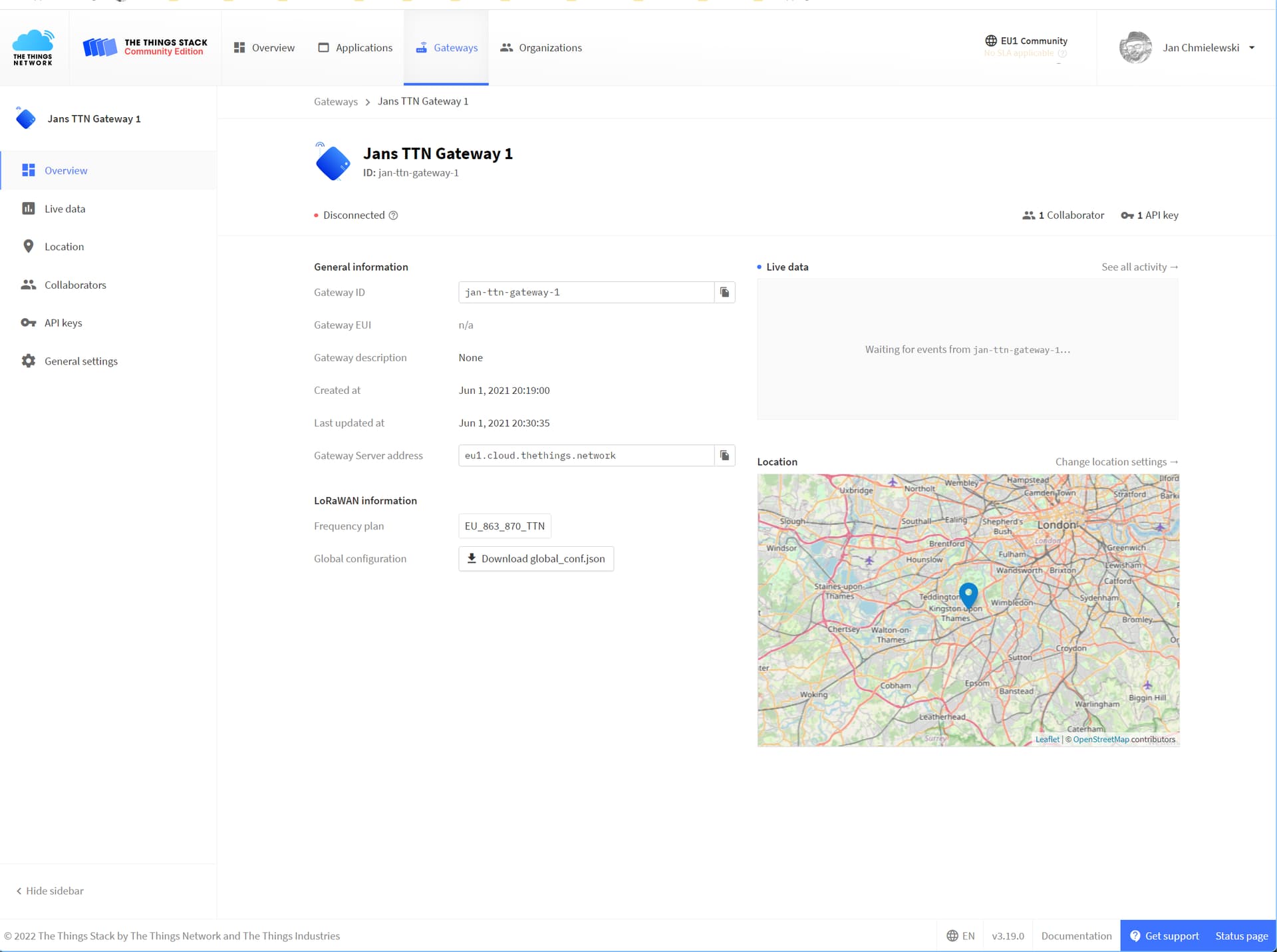

Over at the TTN console end, I set up the new instance of my gateway in June 2021 – in anticipation – however the gateway is showing as “disconnected”.
Why? I have no idea.
What can I do about it? I have no idea.

Can you show a grab of the GW Registration screen/set up in TTN(CE) console (aka V3)?

I will try and upload the screenshot of the TTN Console screen.

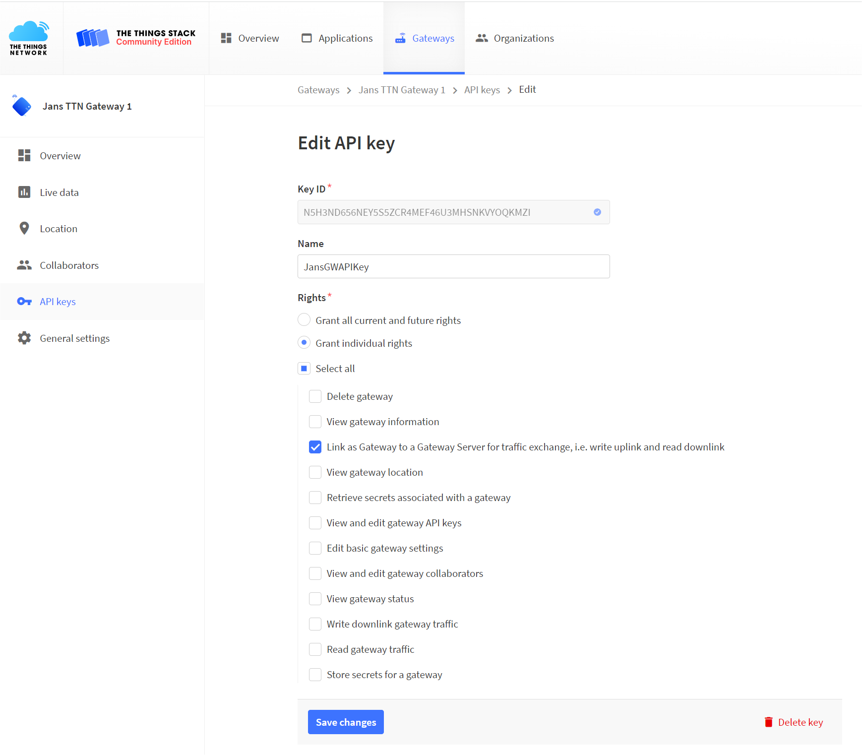

does the GW id you entered on the Gateway Settings page on the GW exactly match what you have put into the console, also have you directly copied/pasted the API key and can you show what option(s)/permission(s) you have set for the key in the console please.

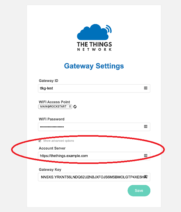

I configured two TTKG’s, over the LAN connection. It was slightly tricky to configure them. One thing in particular was that it would not connect if you chose a WiFi access point right away. It only worked when I left it empty at first, but filled in all of the other things like gateway id, account server and gateway key. Then only later filled in the wifi access point details.

Is the “Gateway Key” on the settings page the same as the “API Key” on the console?
I will upload a dump of the API Key permissions. What should they be?
I tried all of the above (again), starting with the pink button and checking that all the parameters are the same, generating a new API key and entering it as the Gateway Key and setting the Account Server to https://eu1.cloud.thethings.network. The result is that the gateway is at last connected!

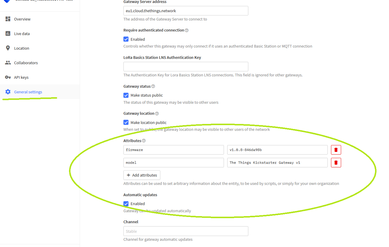

I also tried to upgrade the firmware by downloading the checksums and firmware.hex files from GitHub and putting them in the “update” folder of a FAT32 SD card but, on powering up, nothing apparently occurred and I don’t know how to check the firmware version - going to http://things-gateway.local/ does not offer up a lot of information. How can I find out what firmware is installed? Do I need to use the CLI?

If you look in the V3 console under General Settings – > attributes it will likely show the firmware version - leave the tick box below enabled to get auto update :wink:
