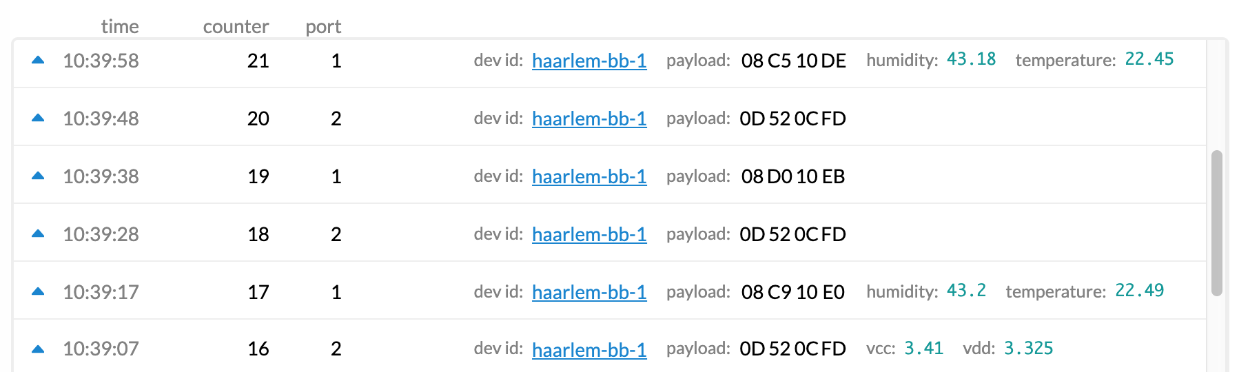

I cannot reproduce this; I simply see the raw (non-decoded) data in all the following error situations:
  • When the Decoder throws an unexpected error (say throws "oops")
  • When the Decoder returns something that cannot be represented as JSON (say return null)
  • When the Decoder defines some code, but does not define function Decoder(bytes, port)
  • When the Decoder is just whitespace
  • When the Decoder is empty (which, after saving, makes TTN Console show the example code, in gray, without any syntax highlighting, just like when hitting “remove decoder”)
In the screenshot below, counters 18, 19 and 20 show the results for erroneous Decoder functions:
Non-decoded data
