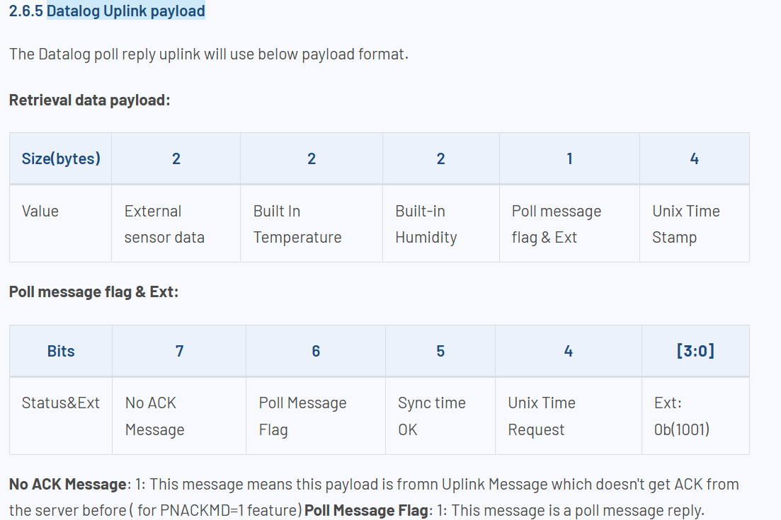

As explained in the guide (Section2.6.5), Datalog Uplink payload is as below:
I realized that the issue is in bit no.6 of “Poll message flag & Ext” byte. Having SYNCMOD and PNACKMD enabled, I saw that after a period of disconnection the samples of that period are correctly sent in an uplink after reconnection and receiving the ACK. Below is an example of a datalog:

I take the first sample as an example: 7fff09f701d2816a539502
and if we take the “Poll message flag & Ext” byte (in this example: 81) and convert it to binary, we get: 1000 0001
As you can see “Poll Message Flag” is 0(!) while the format of the uplink is clearly a datalog one!
This issue has caused the uplink payload decoder to fail recovering these samples.
