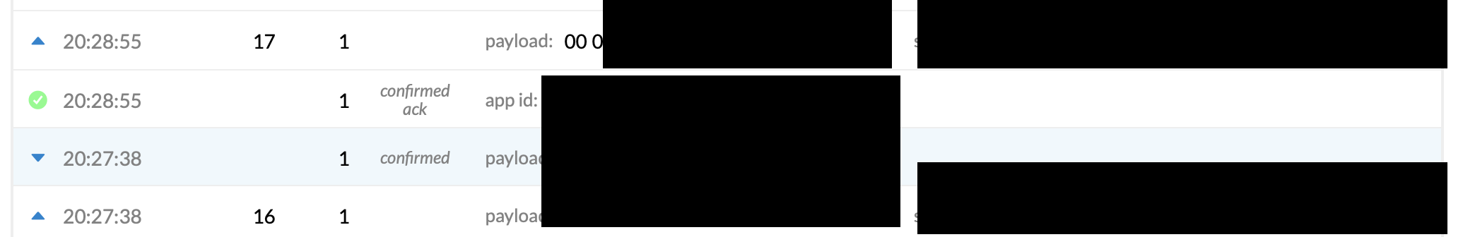

But if sleeping until the next uplink is due does not give you the additional automatic ACK, then that’s even better of course. Are you saying that the code you posted last indeed achieves that, so no empty ACK is transmitted?

Yes!
As you can see in the image the ACK is received and the uplink contains payload.
Nice
