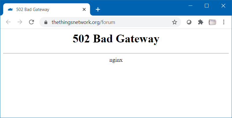

In fact, the whole forum seems a bit flaky at the moment - it’s taken several attempts to get this posted!

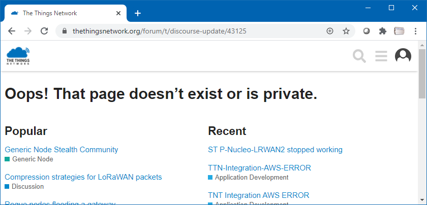

See update from this morning - I too saw some short term trouble posting info/pictures, but appears (largely?!) resolved now - but there may be further interupts as update completes and beds in
https://www.thethingsnetwork.org/forum/t/discourse-update/43125

At one point I was getting an “under maintenance”, but it just referred me to https://status.thethings.network/ - which doesn’t mention the forum.
Also got:
2021-01-22 (5)
The above-mentioned post links to:

My bad I linked a Staff & Mods update thread which is locked from general users, sorry! But you get the message that Forum SW is upder upgrade process any how :wink: Back to normal soon if not already! :slight_smile:
