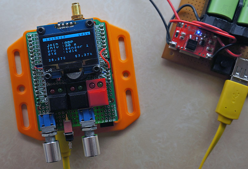

TTN UNO Packet Generator Shield v1.0
onboard :
SSH1106 128x64 display
RTC DS3231
microSPEAKER (for the nice ‘blieb’
TEMP / HUMIDITY sensor Si7021

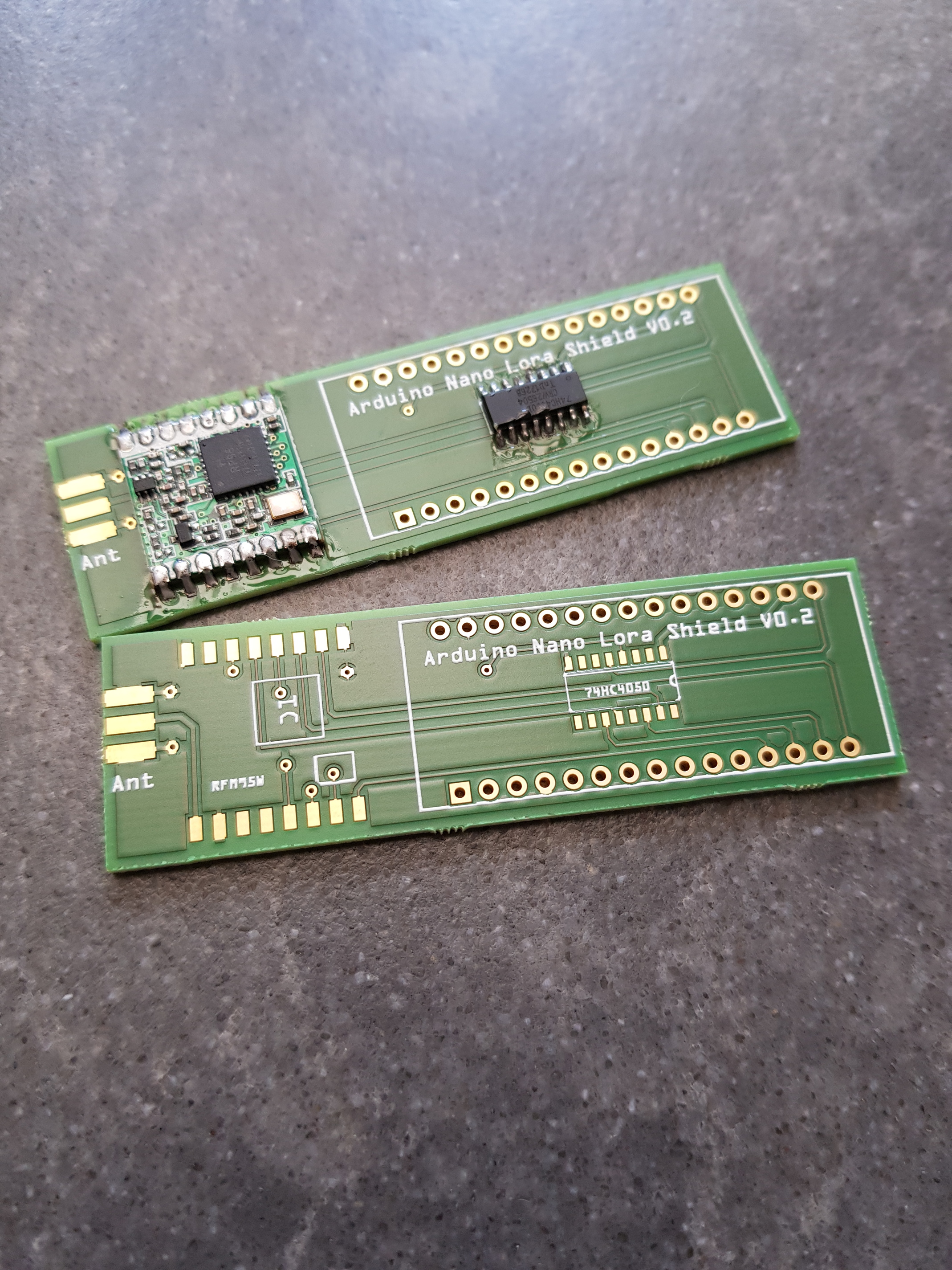

#5
Upgrade pcb for the arduino to v0.2 after remarks from @bluejedi. Add an extra logic level chip and ground plane.
20180724_183318
#6
running
still running on a single AA battery

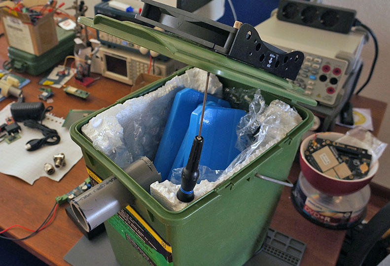

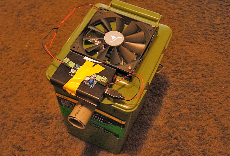

diy battery powered mobile ‘airco’ :sunglasses:
x1001
#8

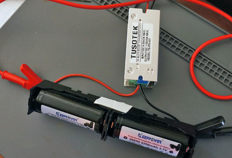

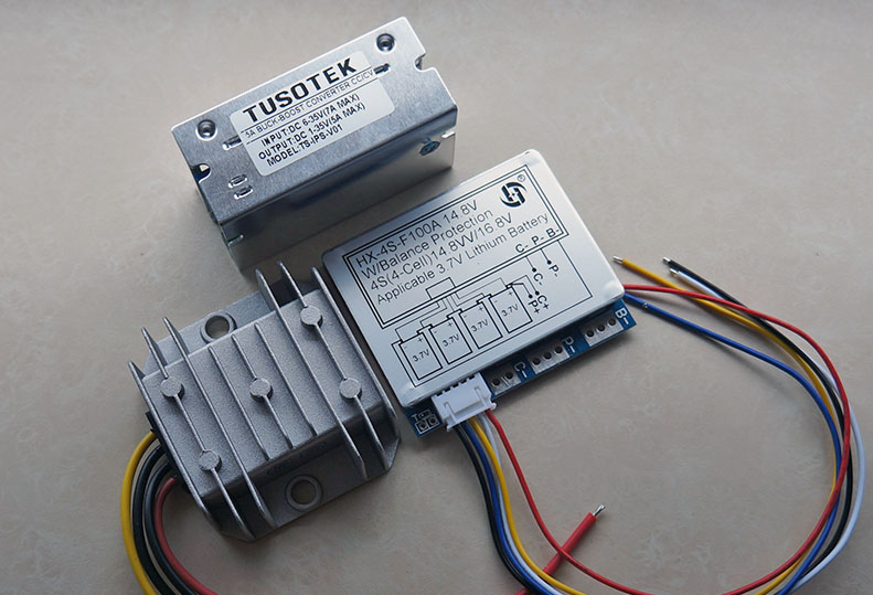

x1000
experimenting with ‘mobile’ power sources
x997
#9
x998
x999
emergency cooling solutions … waiting for more permanent parts :sunglasses:

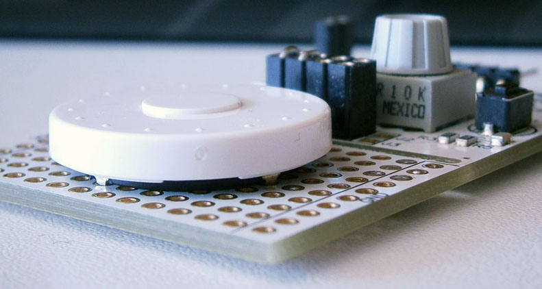

#10

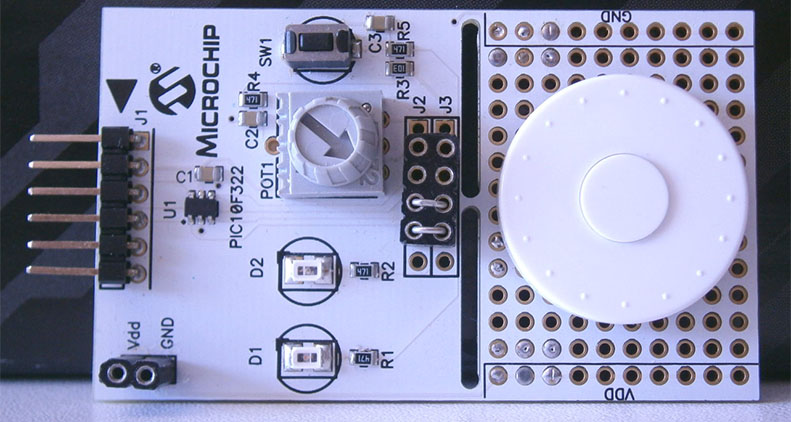

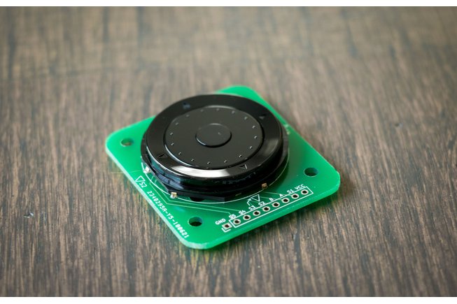

naviwheel
cool ! - Scroll Wheel with Navigation Switch
  • U$33 incl. shipping… that’s to much for me… so DIY
update… found some info / code
1
2

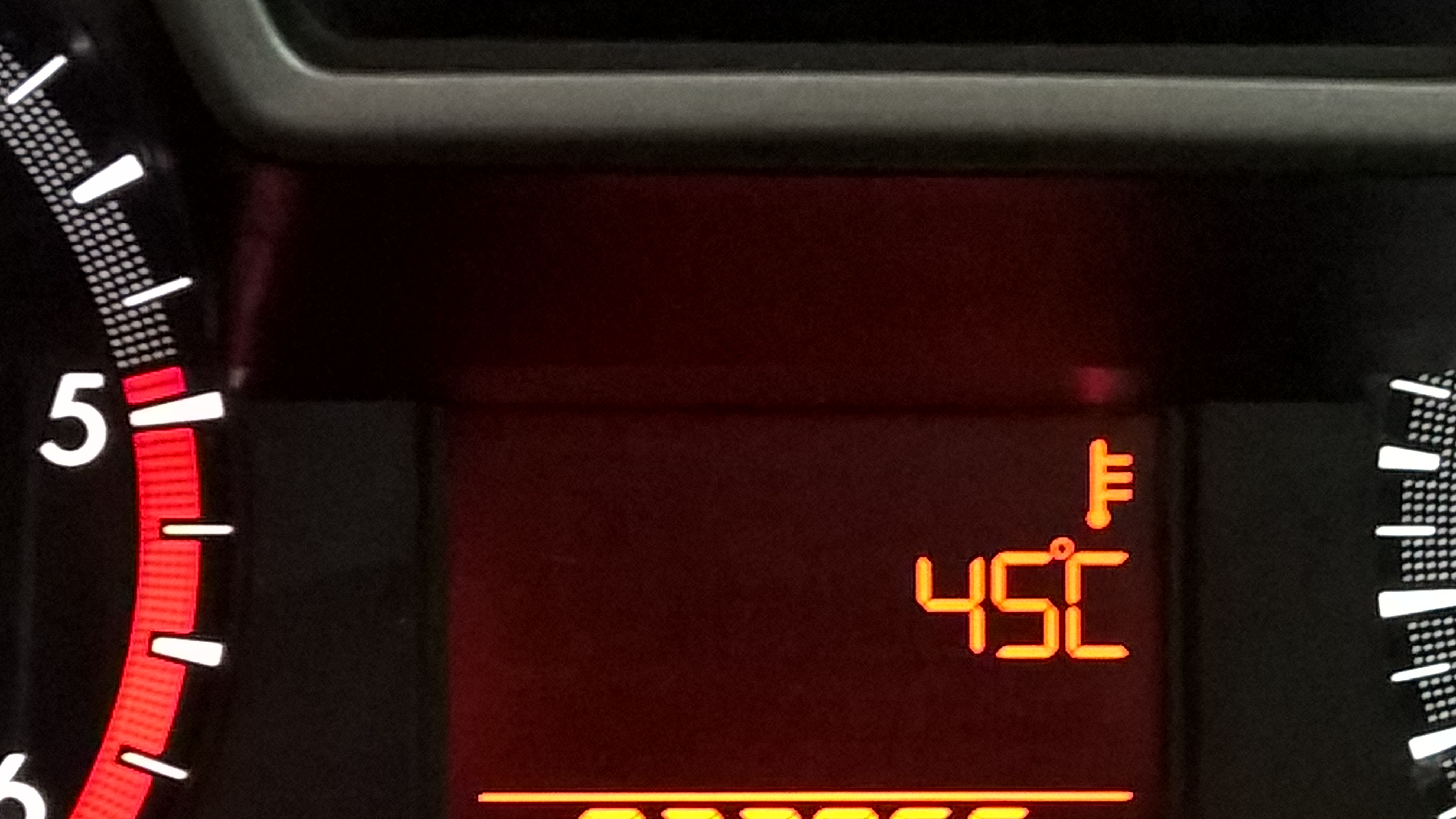

(Tony Smith) #11
@BoRRoZ, it seems to me a lot of equipment is designed for cool climate countries. In many parts of the world, the shade temperature is a bit higher, (see photo) and anything in direct sun will be at least 20C hotter. This is why I design my own gateways, the off the shelf equipment would simply ‘fall over’ down here. 45C
#12

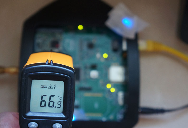

well, the individual parts can probably handle these higher temps… but at the moment here in Holland we have a heatwave and I’m a bit afraid that inside some electronics, like my computers and this gateway, the temps are a bit to high for me… if I can’t touch a chip with my finger than we have a problem
So yes … I agree with you, my solution is making ‘off the shelff’ equipment more robust to the climate

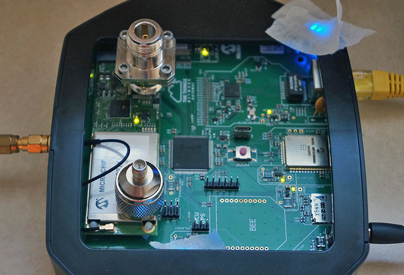

(Tony Smith) #15
This is my idea of a gateway, well above the surrounding obstacles and easy to install. You may have seen this photo published on the Gateway channel on Slack a few times. This is version 1, required a lot of machining to make the enclosure and weather seals don’t achieve sufficient squeeze and will probably become stiff and suffer from “compression set”.gateway

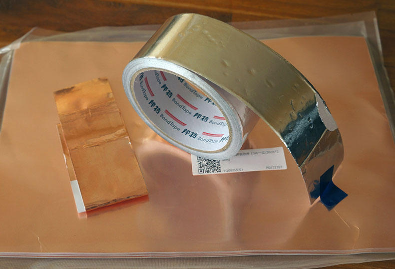

I always like to experiment with materials I find on eBay ect.
This is my latest ‘find’ …
x1001
#17

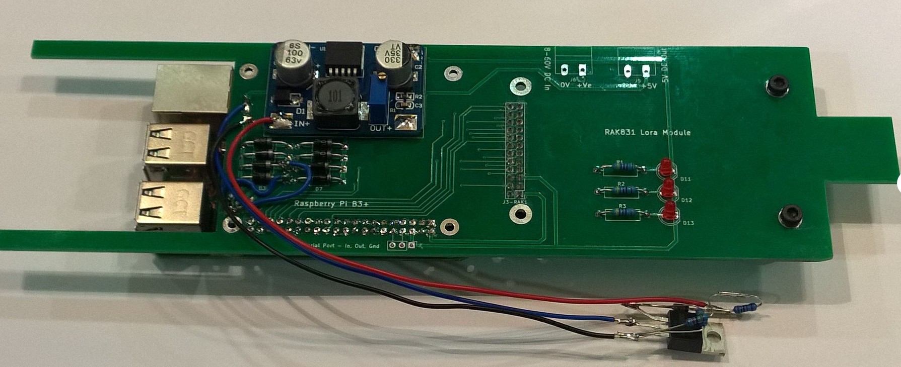

yes… very nice board idea
tsgwpcb
I understand it fits in a tubelike enclosure … but what did you change, to keep the temps and humidity inside the tube under control ?
(Tony Smith) #18
I’ve moved away from a Pi3B+ as this generates too much heat and also looking at direct thermal transfer from the SX1301 chip to the outside ambient air. Trying to reduce the thermal resistance from the chip to the outside ambient air which in current designs this is the sum of “chip - air inside enclosure” plus “air inside enclosure - enclosure case” plus “enclosure case - ambient air”. Each of these thermal resistances are individually high and all add together. The net result is a large temp rise above ambient air temp. Still finalising my latest concept.
