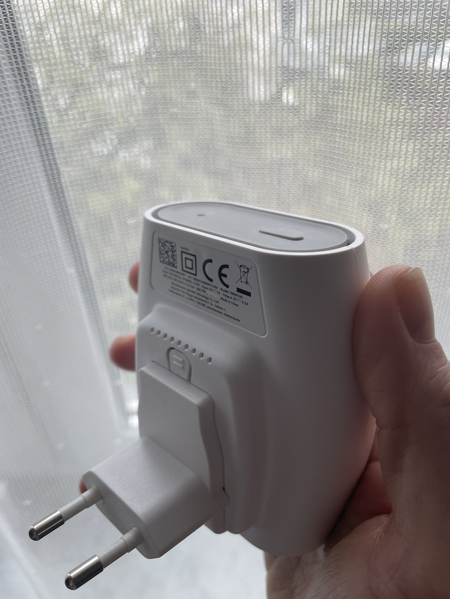

On the label on the back! MAC is the WiFi MAC and for the TTIG (Model TMBH100xxx) is not used to create the GW EUI. All the TTIGâs I have seen the numers start 58a0cbxxxxxxxxxx.

I am experiencing a similar issue and already read that you would need a photo of the back panel. In my company we had a student working on an IoT topic and unfortunately he did not continue with us and did not save his credentials anywhere. I was currently trying to register the device but unfortunately I was not able to do so as it was already registered with his user (EUI A84041ffff228230).
I would be glad to send you the picture of the backpanel but Iâm unable to see how to send a private message in this forum ![]()
