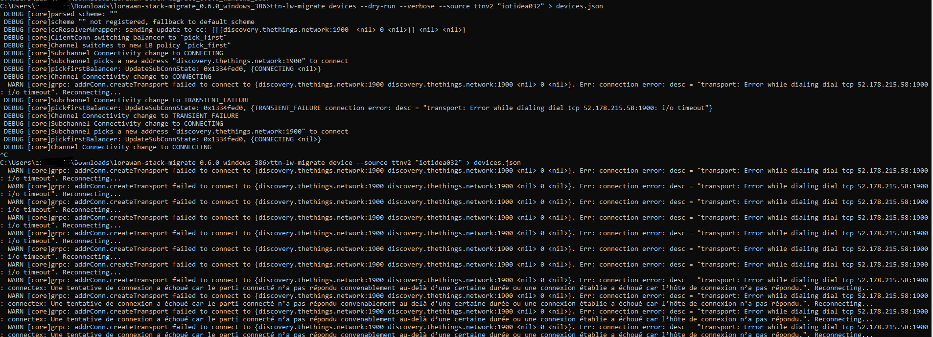

Today it is impossible for me to migrate a sensor via the migration tool ttn-lw-migrate.
It shows me a connection error. (see screenshot)
Is it working with you or is the problem with me?

Bit hard to tell if it’s you or something else as the picture isn’t readable - perhaps you could repost the log as text, not forgetting to format it with the </> tool.
Sorry for picture.
Log :
C:\Users\adm\Downloads\lorawan-stack-migrate_0.6.0_windows_386>ttn-lw-migrate devices --dry-run --verbose --source ttnv2 "iotidea032" > devices.json

WARN [core]grpc: addrConn.createTransport failed to connect to {discovery.thethings.network:1900 discovery.thethings.network:1900 <nil> 0 <nil>}. Err: connection error: desc = "transport: Error while dialing dial tcp 52.178.215.58:1900: i/o timeout". Reconnecting...

What ISP are you on?
Thanks, it’s coming from my internet connection. It’s probably my company’s firewall blocking it.
I switched to LTE and no more problems.
