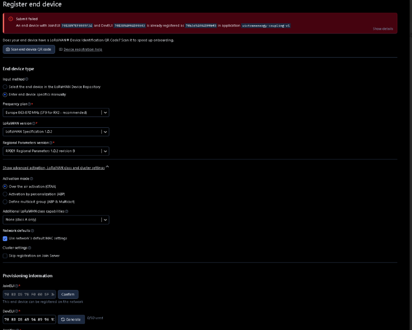

The message that the TTN server returns to me when I want to register the direct V.E that it is already attached to another account, which is surprising given that the seller says not to have registered it?
JoinEUI 70B3D57EF00xxx4
DevEUI 70B3D549948xxxx3 is already registered as 70b3d549948xxxx3 in the victronenergy-coupling-v1 application.
