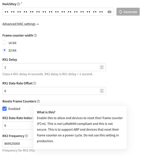

To find the (insecure) “Reset Frame Counters” option (previously known as “Relax Frame Count” and later on “frame counter checks”):
Console V3

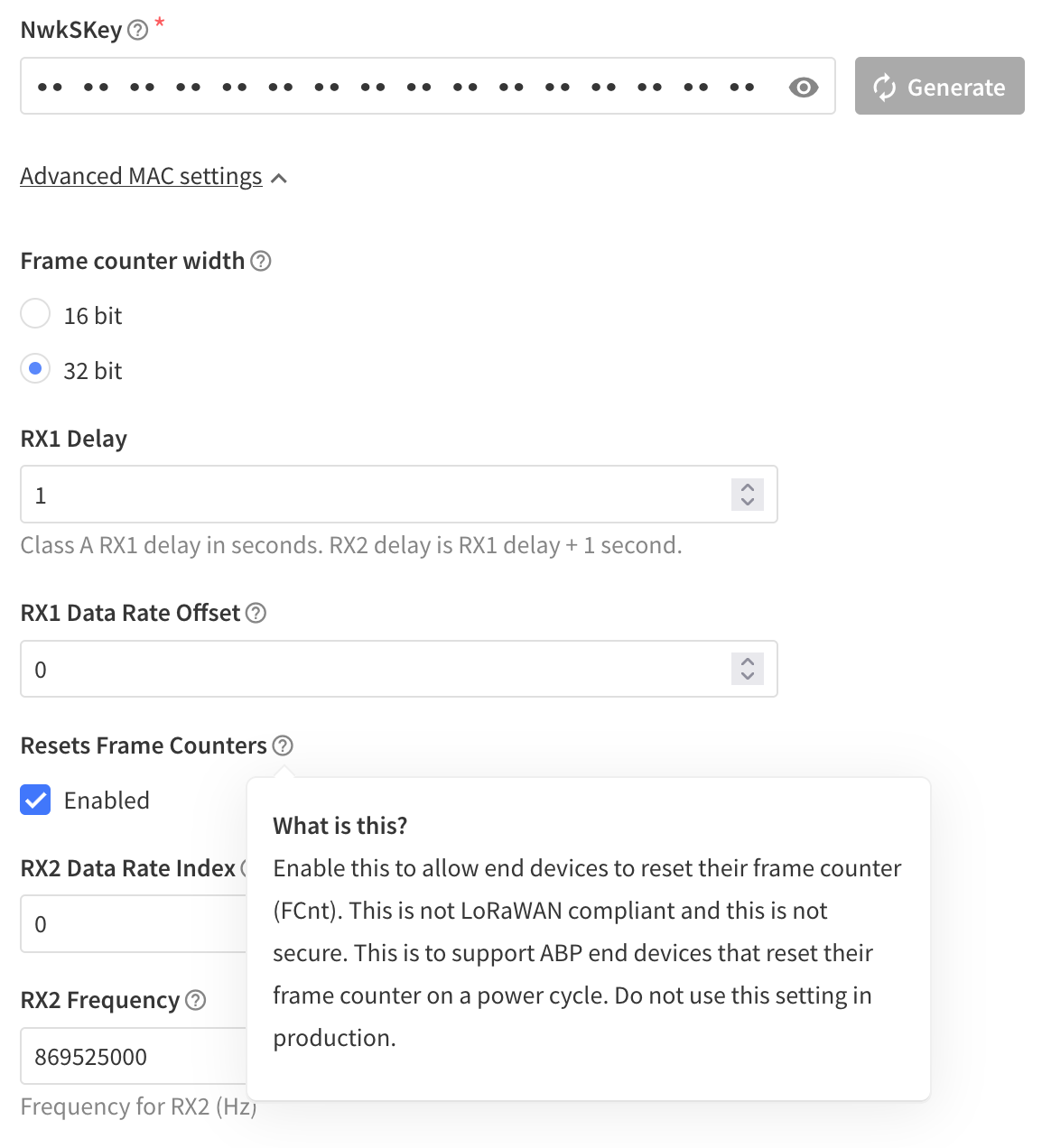

For V3, at least for LoRaWAN 1.0.x ABP devices, “Reset Frame Counters” is in Network layer, Advanced MAC Settings (just below the ABP NwkSKey):
Don’t ignore the warning:
:warning: Resetting is insecure and makes your device susceptible for replay attacks
It seems that in V3 the V2 “Reset Frame Counters” link no longer exists, and the TTN downlink counter is reset automatically if needed.

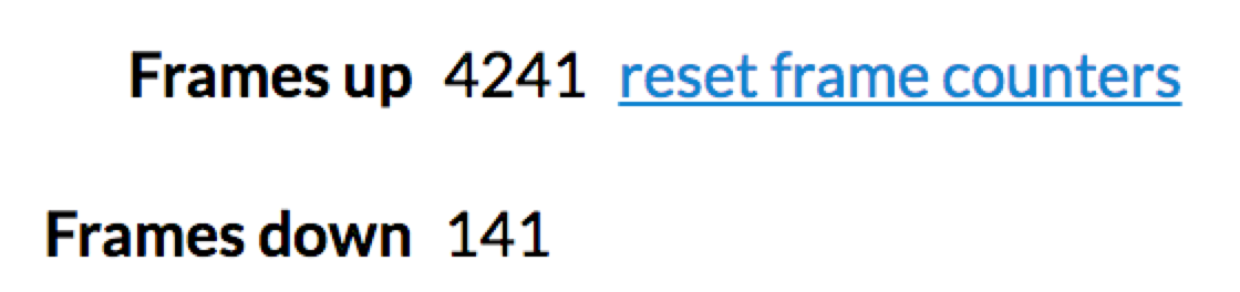

Also note the “reset frame counters” link next to the last known counter values in the Console. If you really know what you’re doing then you can use this to make the TTN backend set both the counters back to zero when needed, without the need to disable the frame counter checks. Beware that resetting the downlink counter requires your device to do the same, for otherwise the device will ignore any downlinks that use numbers that are lower than the downlink count it knows. (Just the opposite of how TTN will ignore low values for uplink counters.) Also, despite the incomplete warning, if the uplink counter already exceeded 16,384 then TTN will not accept any uplinks after resetting the counter without resetting the device as well. You might want to write down the last known values for both “Frames up” and “Frames down” before resetting anything.
