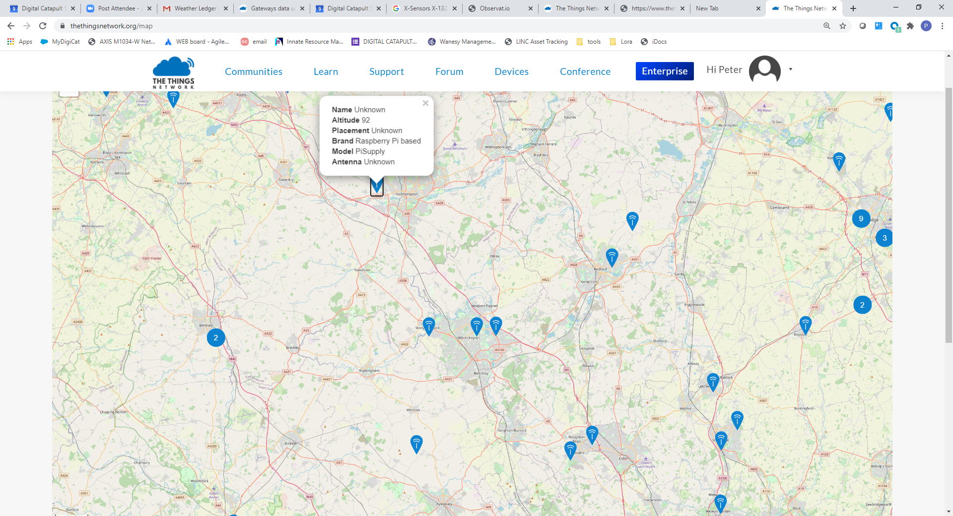

No, seems to be a problem for all gateways (including my Dragino LPS8), at least in the Duesseldorf area. Only altitude and brand name is shown when clicking on the icon.
Ah indeed, details are missing for mine (in The Netherlands) too, though those happen to still include their coordinates.

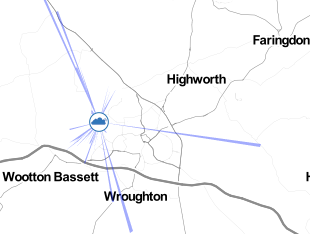

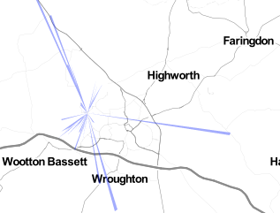

My gateway in Wiltshire, UK has also “disappeared” from the TTN Mapper:
GatewayEvaporatedFromMap
I initially rebooted the gateway thinking it was just me, but I assume it is the same root cause others are observing.
I can confirm my gateway is now missing from https://www.thethingsnetwork.org/gateway-data/country/gb and I also observe “last_seen”:“2020-10-09T14:27:45Z” from https://www.thethingsnetwork.org/gateway-data/gateway/ but it is actively in use since then.

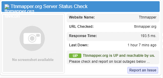

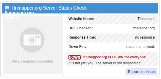

I’m personally not getting any response now from TTN Mapper
TTNMapper

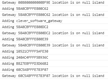

Earlier on the browser console was reporting lots of “location is on null island” for many gateways:
IsOnNullIsland
And meanwhile, @adrianmares also fixed that, for me.

Web site back for me…
TTNMapperUp
…and missing gateway back on the map:
GatewayReappearedOnMap
So all is well in West Swindon, Wiltshire
