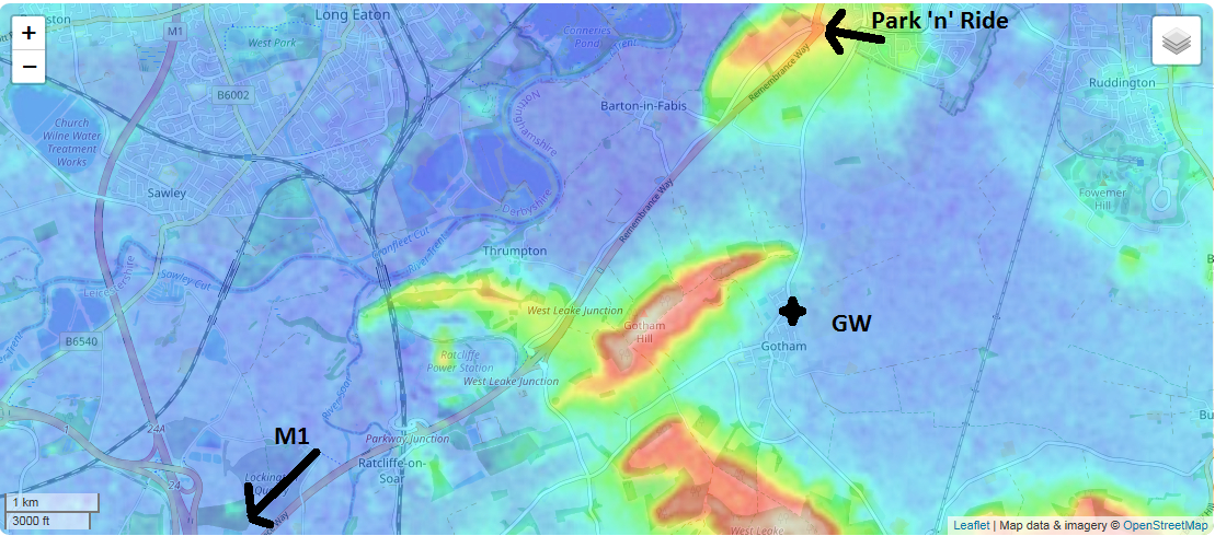

That map of the Nottingham gateways shows I could have been picked up while driving on Remembrance Way by the Gotham gateway.
Tony
I doubt it as 90% of Remembrance Way, along with the Park n Ride are masked by the local topology and specifically Gotham Hill. And that assumes map placement is accurate as users often dither exact GPS location on Map for security reasons (I do for most by anything from 20-200m)
@Jeff-UK If you provide in DM the coordinates I can produce a profile or propagation calculation

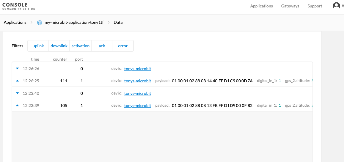

I was getting hits on my console from 12:23, from near to you, with SF12, and I changed to SF7 at 12:31. Then I parked in the car park where I believe you are located. No more hits, so I changed back to SF12 at 12:55. Still no hits, so I drove home, stopping at the Park and Ride for a few minutes. I got a screen grab of the first couple of hits - I realise if I had scrolled right, I should have been able to see the lat and long, but didn’t realise at the time. I saw more hits, but didn’t screen grab. It will be interesting to see yours.

Luckily you enabled the Data Storage Integration, and have the MQTT output. ![]()
You could still type the payload you see into the test field of your application’s Payload Format decoder, for the ones on the screenshot.
Where will I find the MQTT output? And unfortunately, I cleared the screen of the data.

Thou shall click the links. ![]()
But there are two payloads in that screenshot, if you want to know their coordinates.
@tony1tf And there are another 5 shown in the screen grabs I just PM’d you. I need to get a word doc containing other stuff over somehow…
