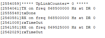

Im using stm32L series and Rfm95.
Region EU868 SF12 BW:125
Device send Join messages succesfully.

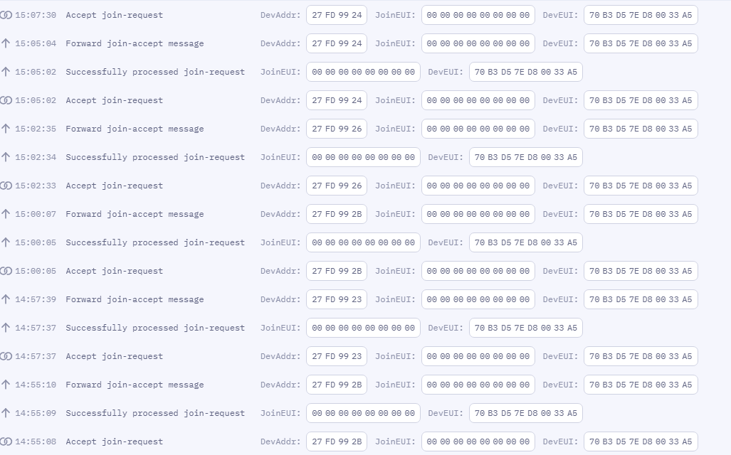

I uploaded below TTN live data messages.
But cant receive any join accept messages. I assume TTN does not send downlink messages to endnode.
