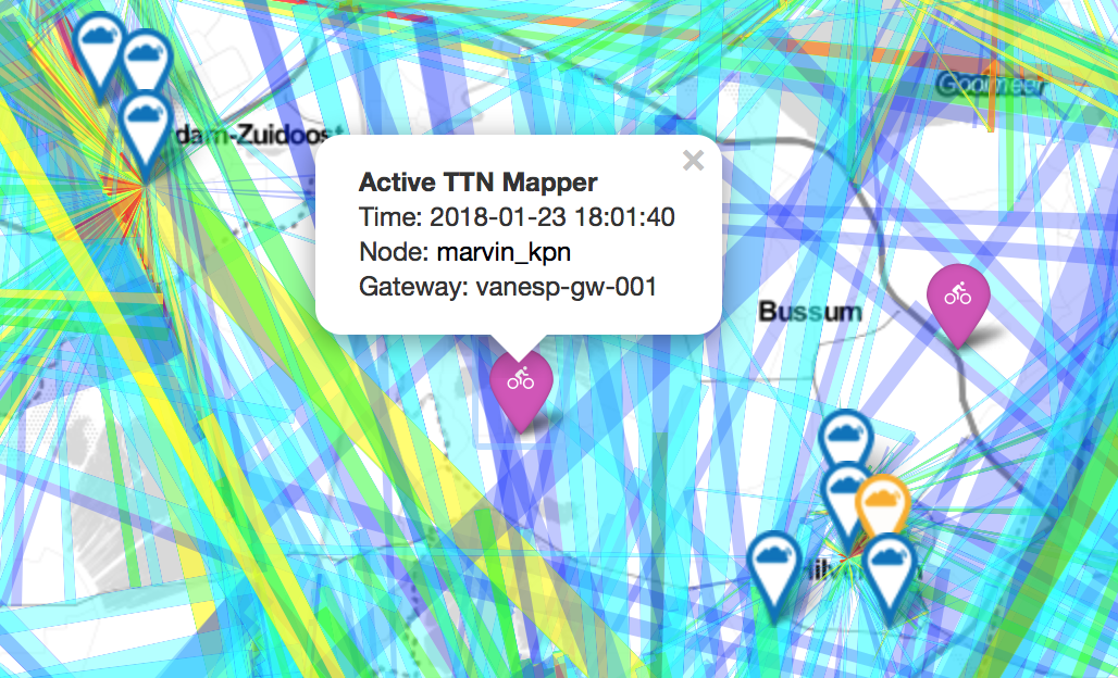

I’m now mapping myself to put the Gateway on www.ttnmapper.org… hoping to fill a void between Amsterdam and Hilversum…
Feel free to make use of my Gateway but the range will be limited until I experiment with and fix the antenna!

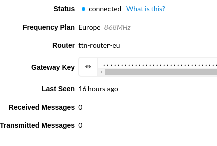

I left my gateway powered on once more during the night, eventually it gets online but I guess this happens when it stays running just long enough to register itself online, in the morning no contact was possible. So it seems the configuration is correct, right?
