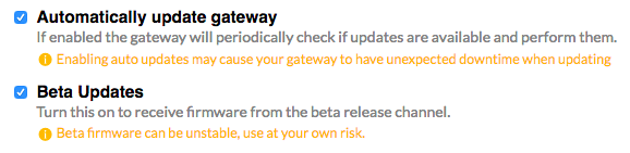

Aha, that’s a new option!
But, would “Beta firmware can be unstable, use at your own risk” have any implication when I brick it?
Yes. We were also sceptical, but both Semtech and Microchip assured us that it’s within normal parameters.
We are working on getting everything ready for Github. They promised us that we could publish it during the conference.
The firmware update does not overwrite the bootloader of the gateway. If things go terribly wrong you’ll be able to flash firmware from an SD card.
Enabling “Beta Updates” in TTN Console does not show anything different than my earlier log. In other words: I don’t see it trying to download the firmware, maybe as it never successfully completed Step 4 of its initial activation.

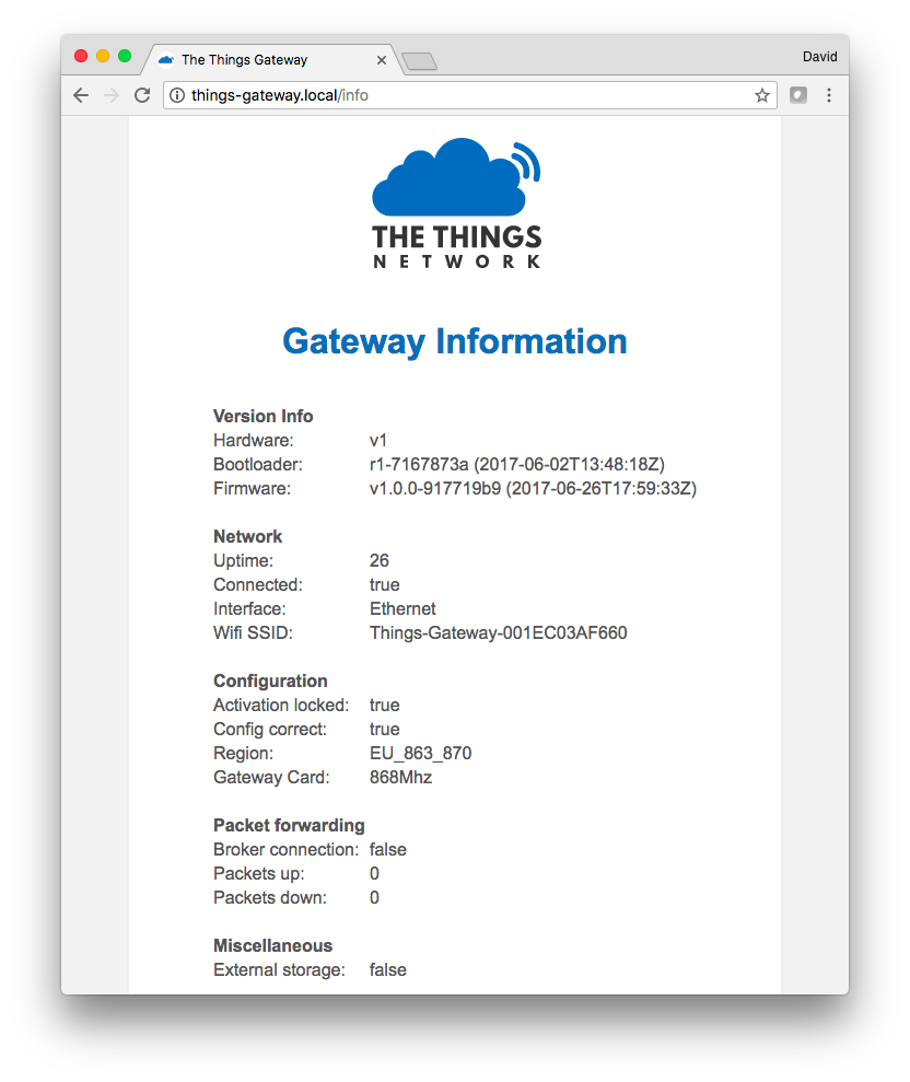

The http://things-gateway.local/info page will keep refreshing its details depending on its internal state. Like: “Config correct” might first show “false” but “true” later, “Region” might be empty first but become “EU_863_870”, and “Gateway Card” might change from “ND” (not detected?) to “868Mhz”.
When trying to use the Ziggo ethernet while the XS4ALL WiFi was still configured, the ethernet’s DHCP would just be too slow for the gateway to get a lease, so it would choose WiFi instead.
Not quite useful, but some URLs: http://things-gateway.local, http://things-gateway.local/info, http://things-gateway.local/id.cgi, http://things-gateway.local/status.cgi, http://things-gateway.local/settings.cgi, http://things-gateway.local/ssids.cgi

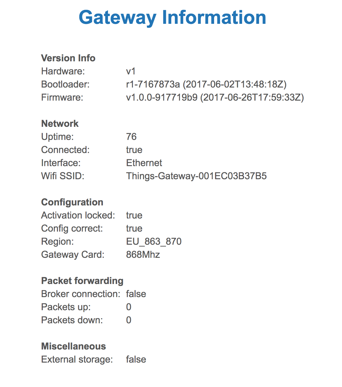

Here is my status… still no luck.
Version Info
Hardware: v1
Bootloader: r1-7167873a (2017-06-02T13:48:18Z)
Firmware: v1.0.0-917719b9 (2017-06-26T17:59:33Z)
Network
Uptime: 265
Connected: true
Interface: WIFI & Ethernet
Wifi SSID: ...
Configuration
Activation locked: true
Config correct: false
Region:
Gateway Card: ND
Packet forwarding
Broker connection: false
Packets up: 0
Packets down: 0
Miscellaneous
External storage: false
Any idea how to progress ?

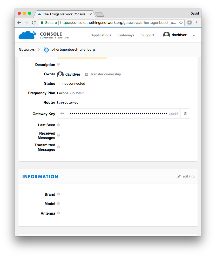

Yesterday the gateway arrived - but unfortunately, same story here. Initial setup through wifi - ending up in boot loop. Second try using ethernet, same story - also after full reset. The device does register on the local network, below the screenshot of the /info page - and also of the console, showing the device never managed to connect. Hoping for a solution as much as everyone else here!
I can’t get my gateway ready to work. After resetting, everything look to go smooth including configuring the gateway. But after a short while, it keeps rebooting. Also no packets are being sent.
Tried to reseat the lora board, but no success. See my configuration page of the gateway that looks correct during some time between reboots.

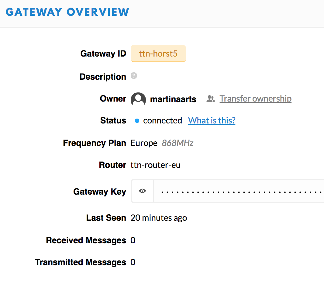

Gateway has been seen by TheThingsNetwork for a short while:
