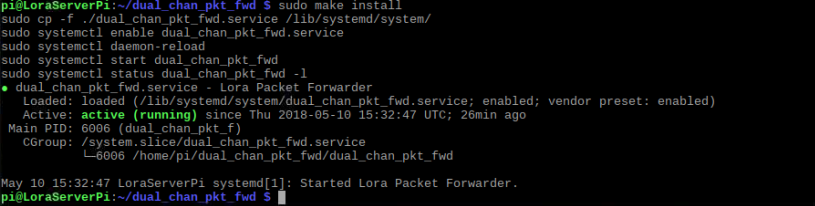

Complete the installation with command
make
sudo make install
The last command ,activates the gateway as a service ( start automatically ) each time the Raspberry is started
NOTE:
The global_conf.json file, is read every time the service is started,
after each change it is sufficient to restart the service

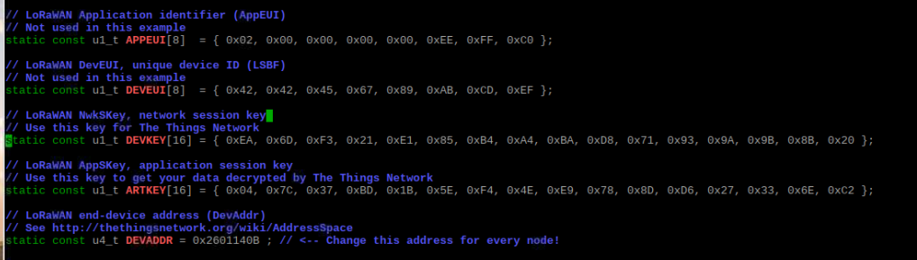

For the test I used a sensor with the code ttn-abp.ino taken from the examples folder of matthijskooijman/arduino-lmic subsequently modified, to transmit, only on channel 868100000
The default installation on the raspberry, / bokse001 / dual_chan_pkt_fwd
receive the messages only on channel 868300000, so I modified the global_conf.json file
by inverting the values of the two freq and freq_2 fields
from
{ “freq”: 868100000,
“freq_2”: 868300000,
to
{ “freq”: 868300000,
“freq_2”: 868100000,
Finally,
in the sensor code, to receive the DownStream message,
I added the following line of code, inside the setup () function, before do_send (& sendjob);
// Let LMIC offset for +/- 10% clock error
LMIC_setClockError (MAX_CLOCK_ERROR * 10/100);

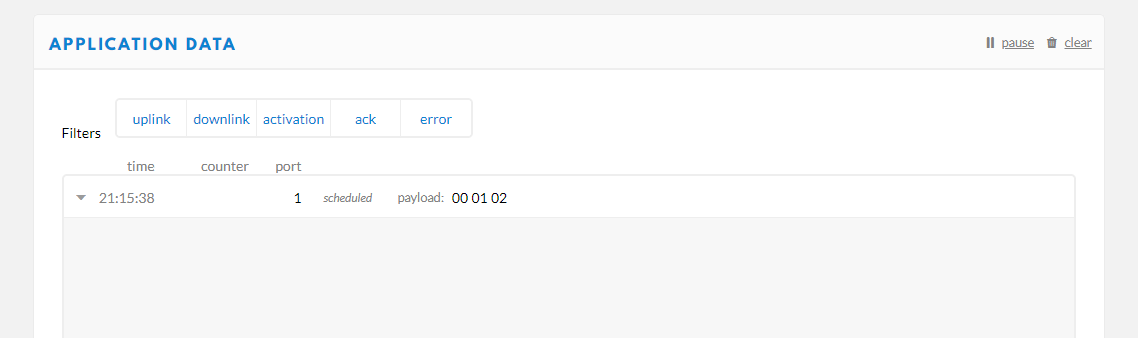

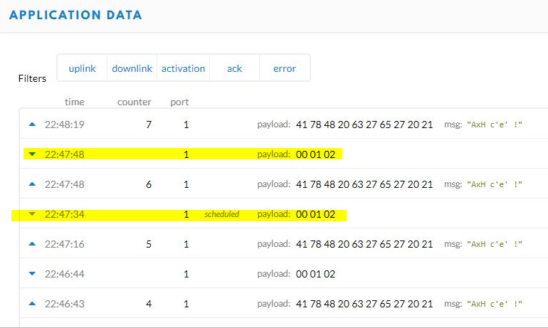

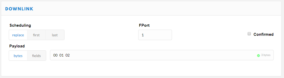

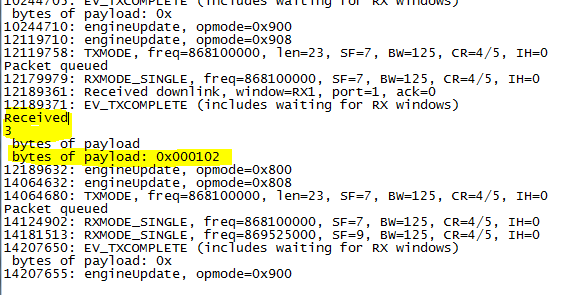

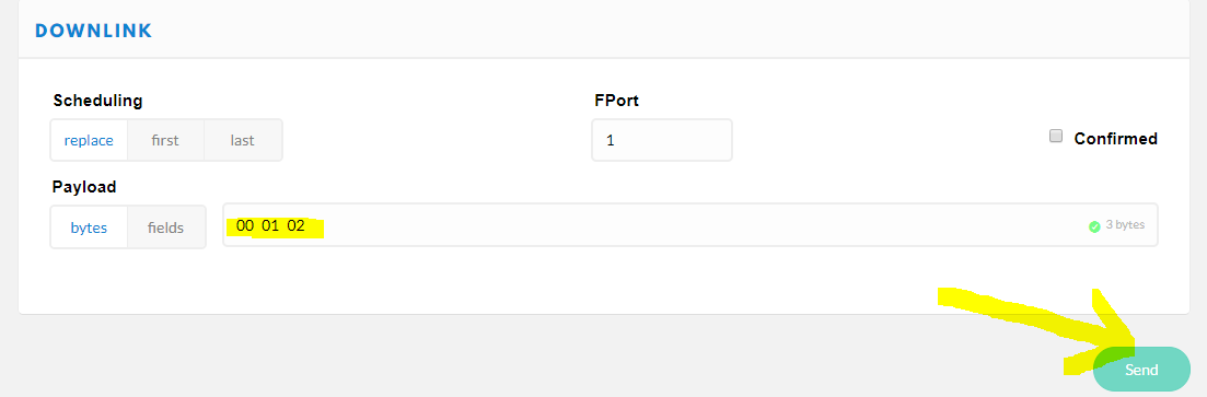

AS I VERIFIED SENDING THE MESAGE TO THE NODE
For the test i used the TTN Console, send bytes message 00 01 02
From Application Data Console
In the node I received

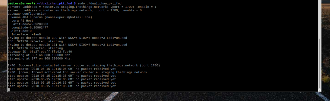

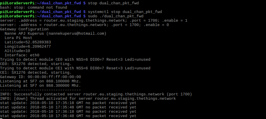

), but I am failing to understand how I forward it to the things network as a gateway. I think I am supposed to input a gateway ID that corresponds to TTN and my RPI with LoraHat, but I cannot find this Gateway ID anywhere on the RPI. The examples that use the (now deprecated) single channel package list the gateway ID as soon as the program starts running:
