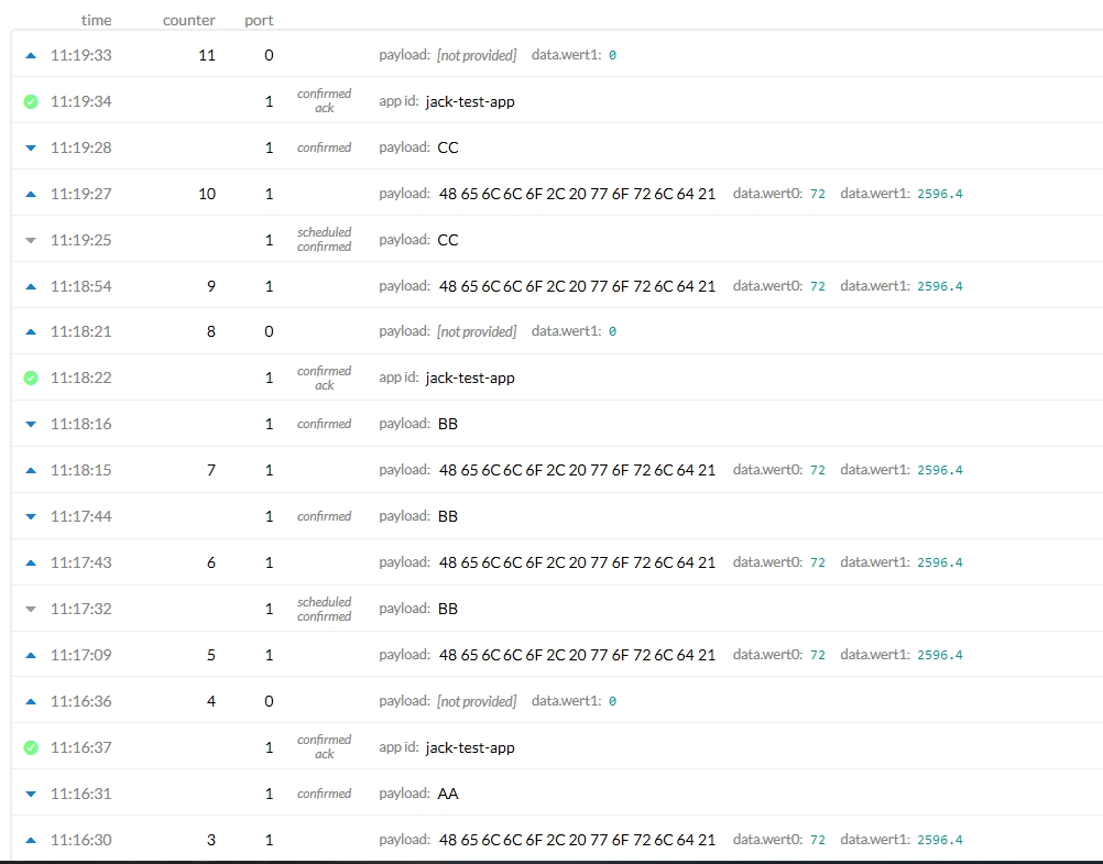

Hi @arjanvanb,
i have checked my code on a short test and the ack for the downlink works fine after deep sleep.
I think the downlink retrys came from a timing problem, because it was the same with or without deepsleep on my ESP32.

Hey together,
sorry for my really late response. I was very busy the last days.
Thank you very much @JackGruber! This helped me a lot!
Everything worked for me except the handling of confirmed downlinks.
I found out that we need to persist the LMIC.dnConf too.
The parameter is declared in the lmic.h file with a comment:
u1_t        dnConf;       // dn frame confirm pending: LORA::FCT_ACK or 0
When loading the data back from the RTC ists important to set the dnConf attribute after calling the LMIC_set... methods because they override this attribute.
I expanded the code from @JackGruber with three lines.

@arjanvanb Did you mean this with “save the state for confirmed downlinks”?
