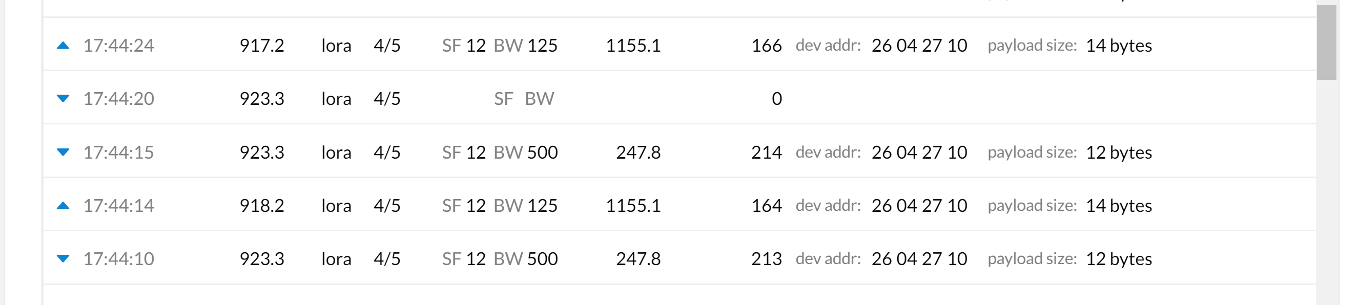

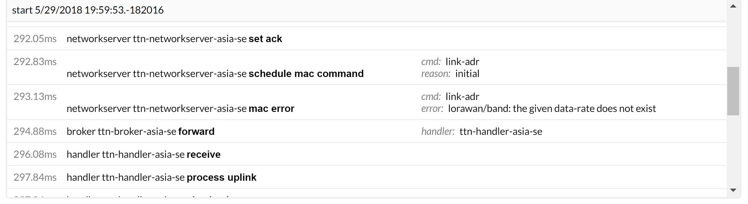

I think I’m seeing the same issue, gateway trace, this is with a RM191, don’t know which is causing the issue
adr
I have been sending a lot of confirmed packets for testing, stuck at SF12BW125, hope this is helpful.

These details could be useful for debugging. Thanks, @AdamJP.
Technically SF12BW125 doesn’t exist for AU915 in LoRaWAN 1.0.1, so the error might be right.
SF11 and SF12 were introduced with the 1.0.2 Regional Parameters.
I think I’m getting some sort of ttn down link now, or its something else … cant tell as I cant open the details:
gateway

These issues have indeed been caused by the fact that our server used to implement the (revoked) 1.0.1 (also called 1.0.2RevA) Regional Parameters. I’ve prepared a fix that updates our implementation to 1.0.2 (RevB), which I hope we can deploy early next week.
