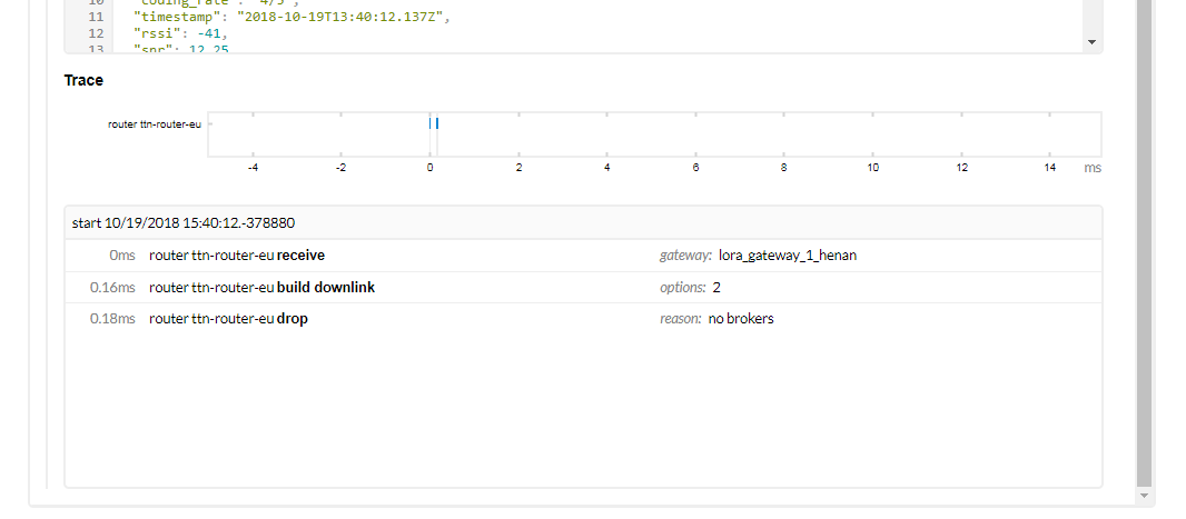

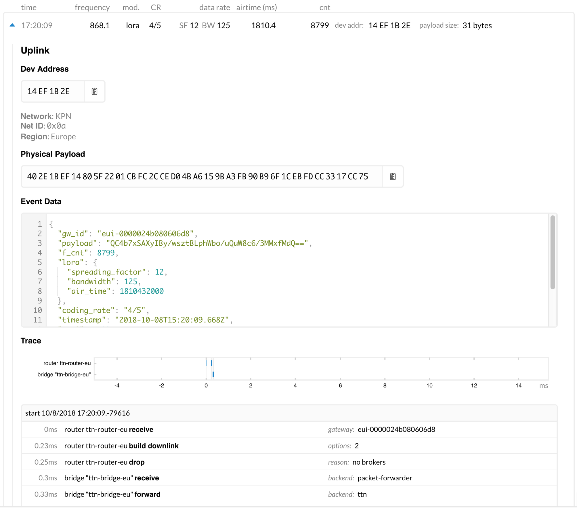

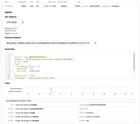

As you wrote your client has deployed a TTN Gateway, you should be able to see some debugging information in TTN Console. Like:
router ttn-router-eu drop reason: no brokers

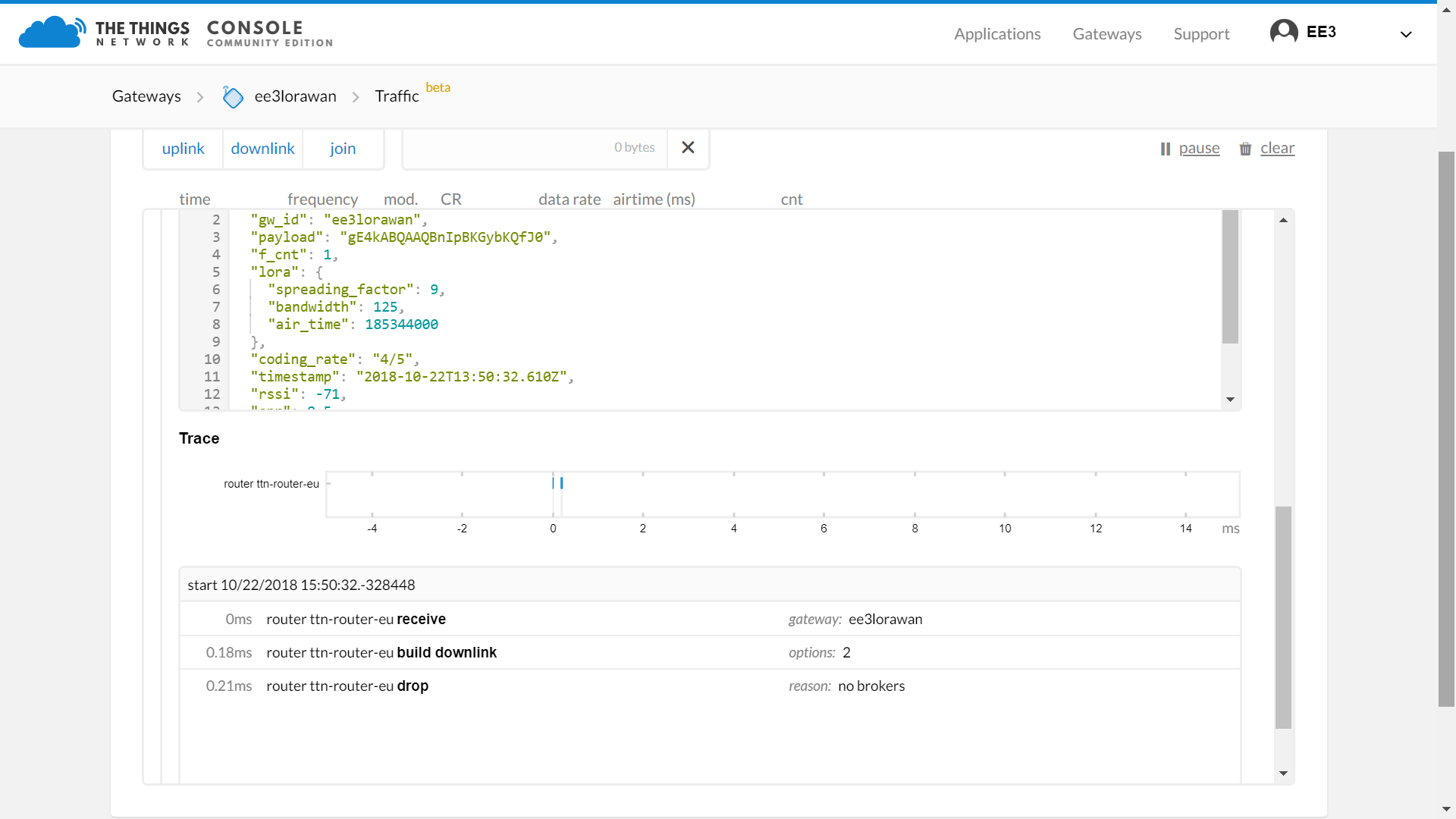

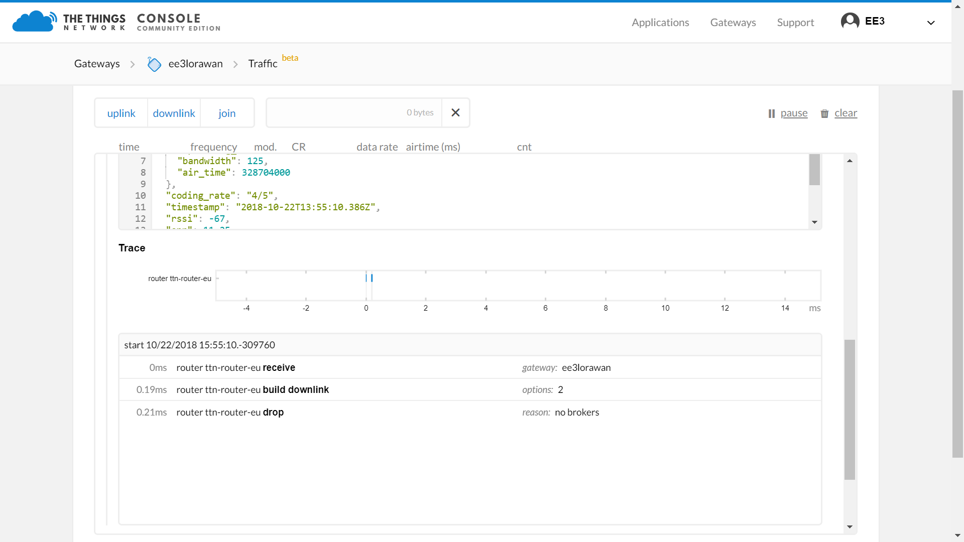

Yes, no brokers is what we’re getting.
We’ve verified that we’re getting “no brokers” also with a different gateway and two different devices.

As the Console also shows, the DevAddr of that message belongs to the KPN network. The “no brokers” message means that the DevAddr is from a range that isn’t currently assigned to any TTN cluster. We only route addresses from TTN-assigned sub-ranges starting with 26 or 27 and the “testing” ranges starting with 00, 01, 02 or 03. Also note that DevAddrs must be assigned by the network server. The only way application developers can assign DevAddrs of their choice, is to use the testing range. This is however not recommended, and the usual advice is: use OTAA.
