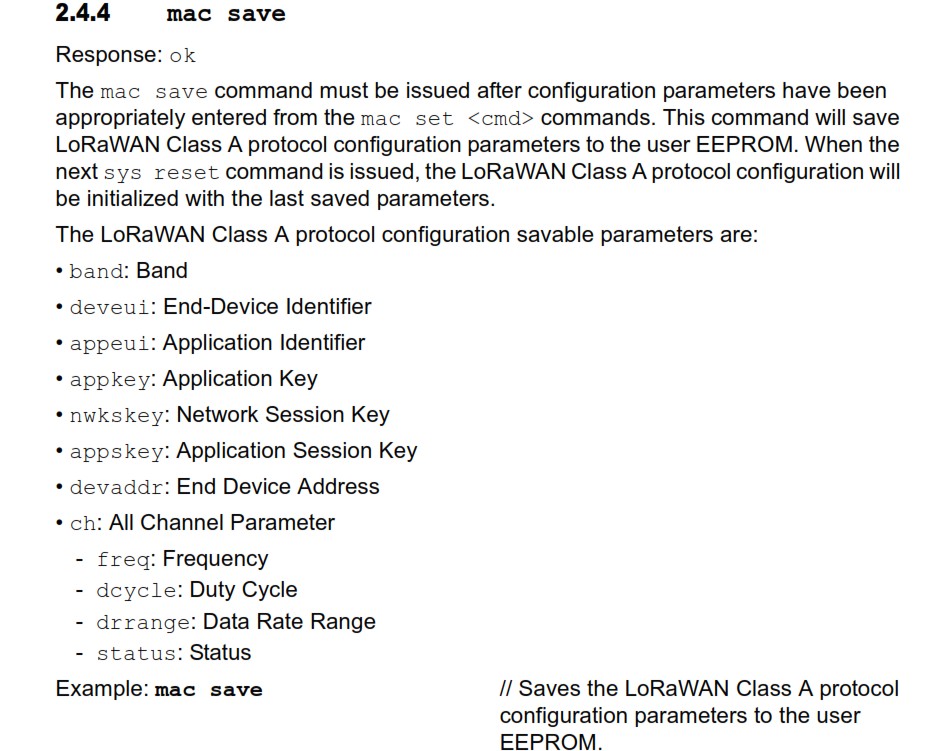

for example the RN2483A
mac%20save
I don’t think a node ever needs to reply immediately. But indeed, like for a confirmed downlink, it needs to store the fact that a confirmation was requested, so it can set the ACK bit in the next uplink. Even if that uplink is days later. When not doing that, then TTN will be required to send the downlink again.
(So I guess mac save indeed does not suffice there. But I even don’t see the frame counters mentioned above, so maybe mac save is just not the right command at all, or though the documentation is outdated, see below.)

As an aside, since version 1.0.0 the RN2483 mac save command saves much more, and does include the frame counters, but no mention of the pending MAC command responses. (But maybe more recent versions even include that?)

Issuing a “sys factoryRESET” may help to get an ‘accepted’ reply from RN2483A module. If you use “mac save” be sure to have valid data for devaddr, appeui and appkey. This project may help too: https://github.com/thomaswesenberg/LoRaWAN-device-GPS-RaspBerry-Pi
