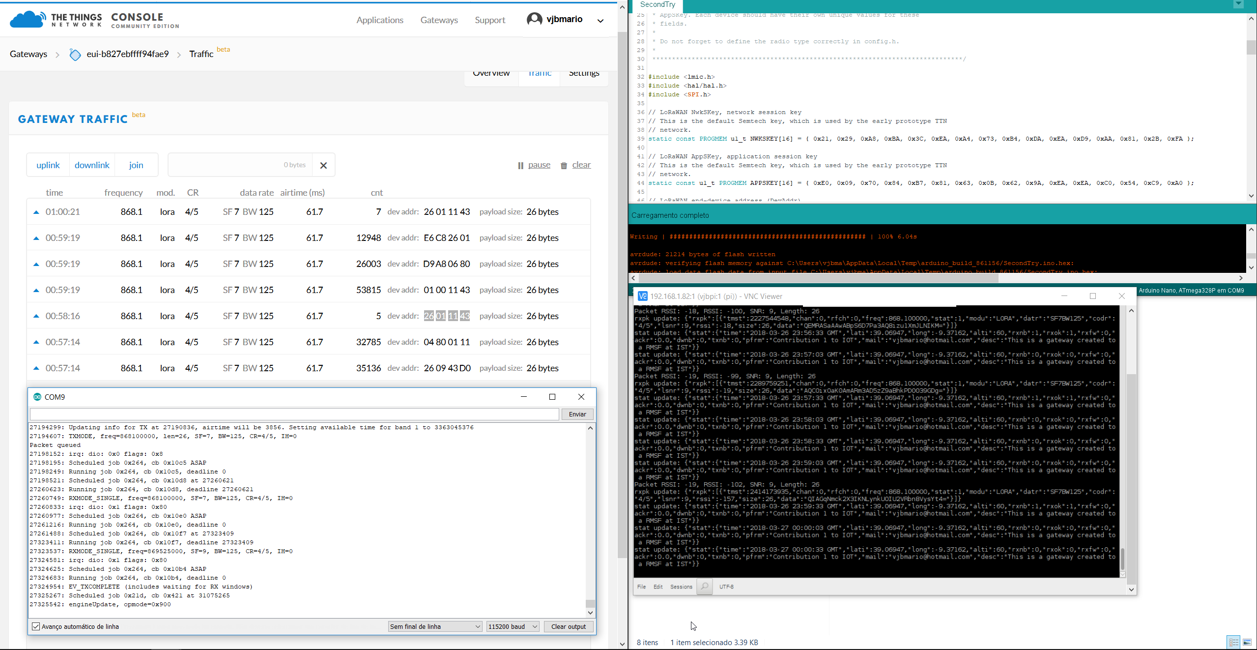

Hello Guys,
First of all thank you so much for the information. I am really new in this world, and I am trying to build the complete system, LoraWan Gateway (Raspberry Pi 3B + Lora Shield v1.4) and a device (arduino nano connected to Lora RFM95).
I have already did the systems with help of this 2 tutorials:
And after I edit my code as arjanvanb explain to have transmission single channel… What is very strange for me is that I can always receive the transmission in LoraWan Gateway but after when I see in ttn site in data, sometimes the addr is wrong, as can be seen in the picture… Anyone understands2018-03-27_01-00-51 why?
Thank you so much and I hope you could help me :slight_smile:
Best regards,
Valter Mário
Why do you think the DevAddr is wrong? Which one do you expect?
Seems to me that your gateway is simply also receiving LoRa (or LoRaWAN) packets from other devices, which are not yours. That is to be expected, as the gateway radio receiver just listens and forwards to TTN, which will ignore the packets when from unknown devices. (A TTN DevAddr always starts with hexadecimal 26 or 27.)
Looks like you are also forwarding packets with CRC errors. If so, please disable that.
While testing make sure to keep at least 3 meter between the node and the gateway.

Note: my end device and my gateway are based on RPI+LoRa GPS HAT.
The code supports ABP, but there is no example how to do it.
You can check the example given here:
The important lines are these:
// LoRaWAN NwkSKey, network session key
// This is the default Semtech key, which is used by the early prototype TTN
// network.
static const PROGMEM u1_t NWKSKEY[16] = { 0x2B, 0x7E, 0x15, 0x16, 0x28, 0xAE, 0xD2, 0xA6, 0xAB, 0xF7, 0x15, 0x88, 0x09, 0xCF, 0x4F, 0x3C };
// LoRaWAN AppSKey, application session key
// network.
static const u1_t PROGMEM APPSKEY[16] = { 0x2B, 0x7E, 0x15, 0x16, 0x28, 0xAE, 0xD2, 0xA6, 0xAB, 0xF7, 0x15, 0x88, 0x09, 0xCF, 0x4F, 0x3C };
// LoRaWAN end-device address (DevAddr)
static const u4_t DEVADDR = 0x03FF0001 ; // <-- Change this address for every node!
and
 #ifdef PROGMEM
    // On AVR, these values are stored in flash and only copied to RAM
    // once. Copy them to a temporary buffer here, LMIC_setSession will
    // copy them into a buffer of its own again.
    uint8_t appskey[sizeof(APPSKEY)];
    uint8_t nwkskey[sizeof(NWKSKEY)];
    memcpy_P(appskey, APPSKEY, sizeof(APPSKEY));
    memcpy_P(nwkskey, NWKSKEY, sizeof(NWKSKEY));
    LMIC_setSession (0x1, DEVADDR, nwkskey, appskey);
    #else
    // If not running an AVR with PROGMEM, just use the arrays directly
    LMIC_setSession (0x1, DEVADDR, NWKSKEY, APPSKEY);
    #endif
