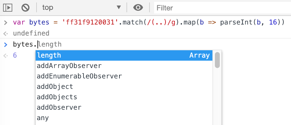

Also, you can use auto-completion in the developer tools of your browser. Just start by defining your payload with something like:
var bytes = [0xFF, 0x31, 0xF9, 0x12, 0x00, 0x31]
Or, to easily copy/paste a hexadecimal string such as 0xff31f9120031:
var bytes = 'ff31f9120031'.match(/(..)/g).map(b => parseInt(b, 16))
Next, typing bytes. will show you the supported functions and all:
